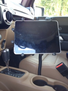

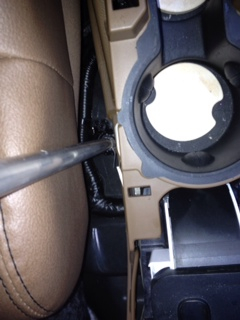

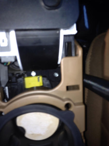

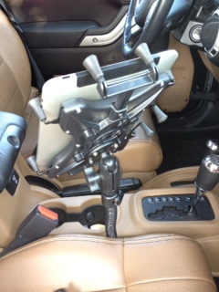

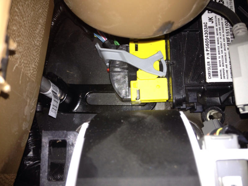

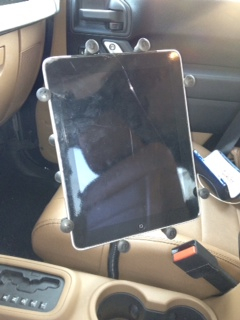

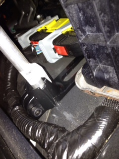

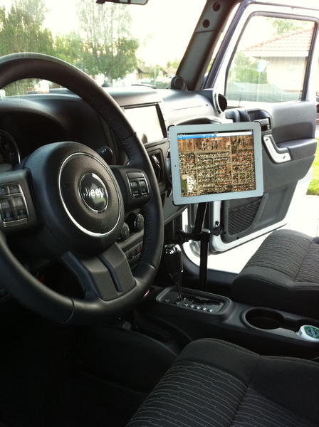

Another RAM mount that I installed coming up between the console and passenger seat after I dropped the IPad out of the car and cracked the screen.
I went ahead and mounted to the floor under the console which was a bit of a pain since I had to partially remove the console and detach the auto gear casing to give more work room. With more access to longer drill bits and slimmer socket wrenches this may be avoidable.
I also replaced the aluminum rod that RAM provided with one a little more rigid since I did not need it to bend.
I intend to add an IPhone mount which will tie into the back of this mount but have not done yet. Hope is helps
