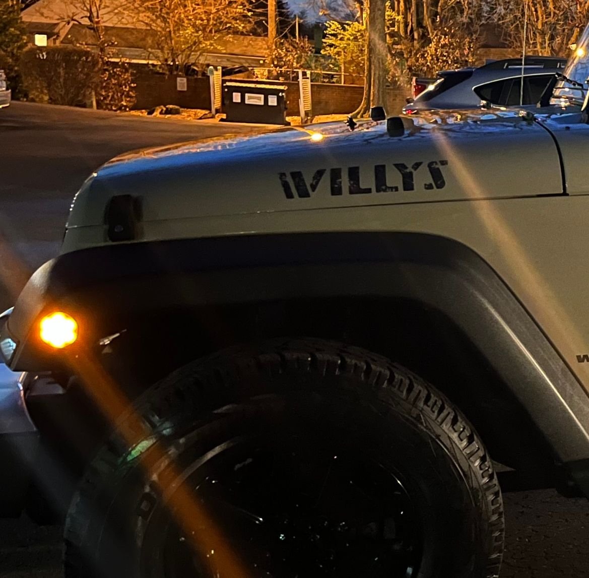

Just picked up a 2016 Unlimited Willys today with only 19k miles. This thing is immaculate, and I love the Mojave Sand color. This evening as I was looking around the vehicle and soaking it in, I noticed I had some issues getting the locking hood latches to go into place properly after opening the hood. They will latch fine, but not to the point of being able to actually lock, which was odd to me. Upon noticing this, I also noticed the hood and fender gap is almost non existent near the very front of the vehicle. There is also paint chipping away down to bare metal where the hood and fender are touching, on both sides. I decided to give the underside a look, and come to find there are no rubber grommets or anything establishing a gap to prevent this from happening like most vehicles. I’ve done tons of research this evening and can’t find anything at all. All I know is other Jeeps I’m looking at don’t appear to have this lack of a gap? Is this normal or is something definitely wrong here? I’ve worked in body shops for going on 6 years and have never seen a vehicle without rubber grommets/stops under the hood. For the record, it has never been in an accident or anything that would indicate a prior issue that would be causing this.

Yeah when you leave it unlatched, there’s relatively no issues at all with the fitment. It seems like it wants to sit more to the driver side but that feels influenced by the part of the latch attached to the fender. It’s when you latch the hood that it is forcefully pulled into the fender. The hood appears to never have been removed. Of course the dealer wants it back to “fix the alignment of the hood”, but I’m positive it’s because of the latches. Which at that point they said they “can’t mess with aftermarket parts”. But then tell me not to mess with it myself because I bought it this way. Typical dealer crap lol. I’ll get some pics later to show what I’m referring to. You can see the gap in this photo and the latches.
