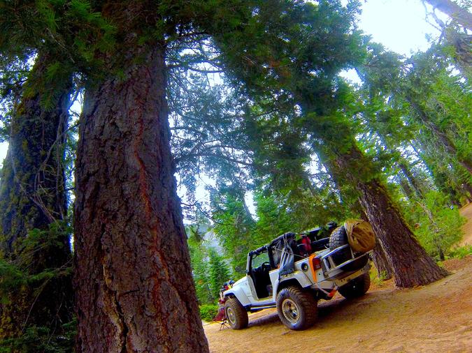

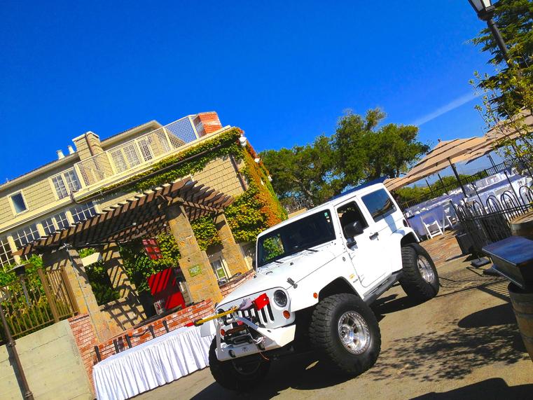

Don't let the Sahara badge fool you. It's more than capable for even the Rubicon trail if setup right with a few moderate upgrades. For winter, you'll have the limited slip diff in the rear. If you really need the extra traction you can always install a selectable locker for the front axle.
Pics of mine still on stock axles, 3.73 gears, rear limited slip diff, front open diff, 2.5" lift, skids/sliders, beadlock wheels....
