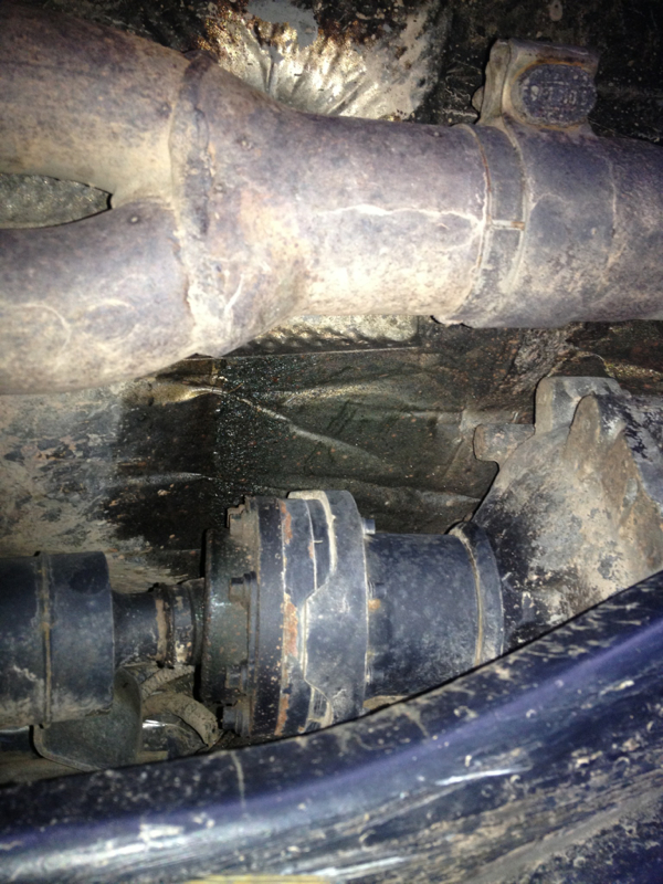

Simply stacking additional spacers may cause more issues than what you have now. Usually lifts over 2.5/3" will cause suspension geometry problems. You may need to add adjustable control arms ect. ect..
My 2.5" AEV ended up at 3" which caused a failed front driveshaft.

Simply stacking additional spacers may cause more issues than what you have now. Usually lifts over 2.5/3" will cause suspension geometry problems. You may need to add adjustable control arms ect. ect.. My 2.5" AEV ended up at 3" which caused a failed front driveshaft. <img src="https://www.jk-forum.com/forums/attachment.php?attachmentid=625888"/>
Not really. If the bumper sagged 1/2" and you stack in a 1/2" spacer the vehicle is sitting at the same previous height having no impact on driveshaft or geometry. As long as the op doesn't add longer shocks or increase the height beyond the amount of sag he will be fine.
I had a 2" AEV bb on my jk before coilovers. The front consisted of a factory rubber spacer and the new spacer stacked. The rear was a completely new spacer.
