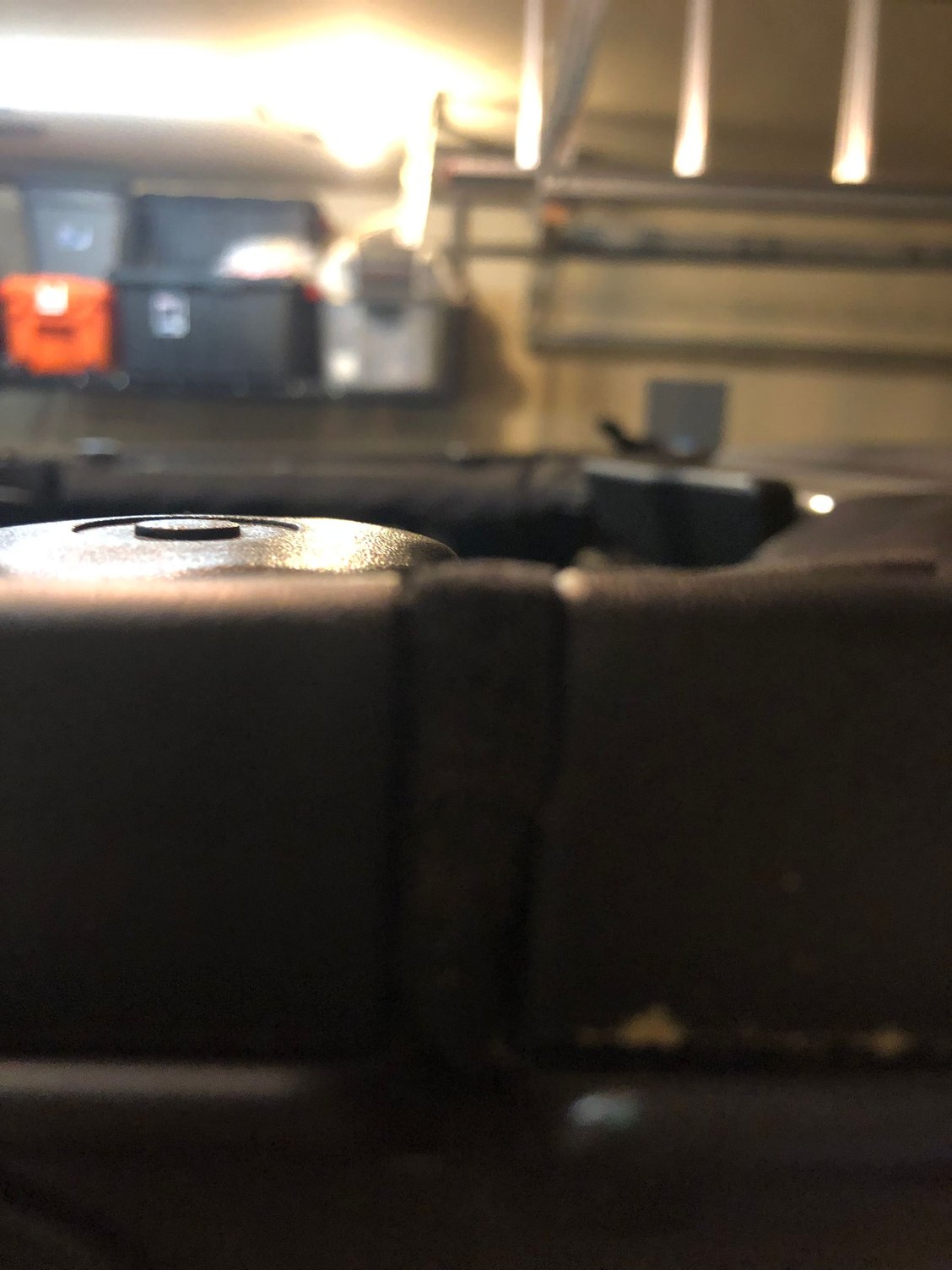

can someone help me identify the foam seal that goes between the front surround and rear surround for 2014 JK unlimited soft top?
I have a slow leak on the drivers side that appears to be coming from this seal.
I would like to replace the seal but don’t know where to start to find it.

BestTop makes the soft tops for Jeeps. I called them and ordered a full foam seal replacement kit. I have a 2dr and it was like $13.

Apparently you cannot buy just the seal. I’d have to purchase a new front door surround. I found it for $69, so not too bad. Other option is to make my own seal out of weatherstripping.
