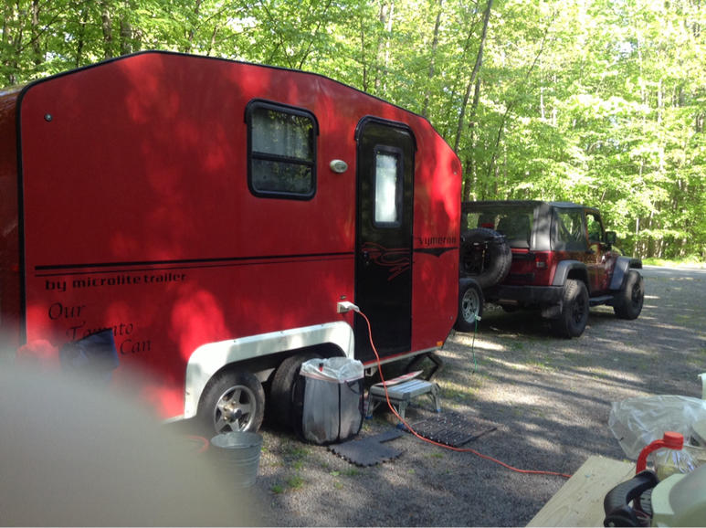

We have a 2013 2 door and pull a camper with no problems. It is a Vymeron made by Microlite. They have a web page and are on Facebook. It is one of the best investments we made. I searched a long time because I wanted to find a camper I could pull with the Jeep. They are all aluminum so they are light in weight. I would recommend that whatever camper you buy install electric brakes. It does make a difference in stopping and if you need them only once for a quick stop you will be glad you have them.
