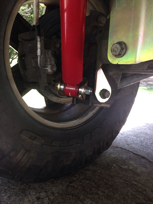

... My JKUR sits on MC2.5" dual rate coils front and rear, also the rear bott mounts have been move up, using the MC shock re locator and abt 3" trimmed from the existing bott mount and the top mount is stock ..
The present shock measures 19.5" eye to eye at rest... If I us rs7331 it has collapsed dim of 16.5 and extended dim 26.76...... Giving 10.26 travel... Is the roughly 3" up travel going to be a prob????
