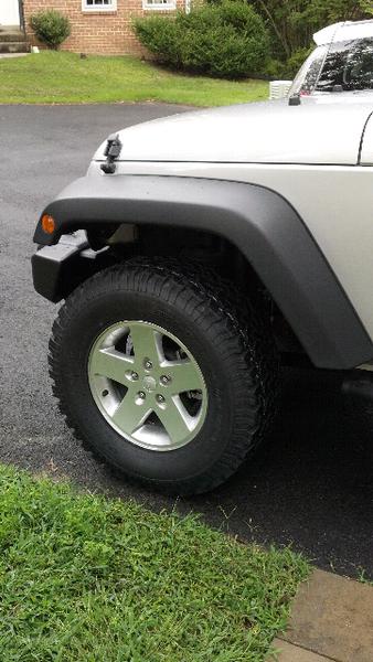

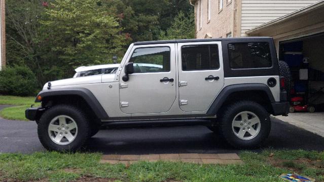

Well kit looks great and tires finally got mounted this afternoon. It is definitely better looking and bigger now.
Old Aug 26, 2012 | 02:59 PM
cwfunrider's Avatar
Posts: 109
From: Lakeridge, VA
Still looks raked in the side shot but my driveway in sloped.
