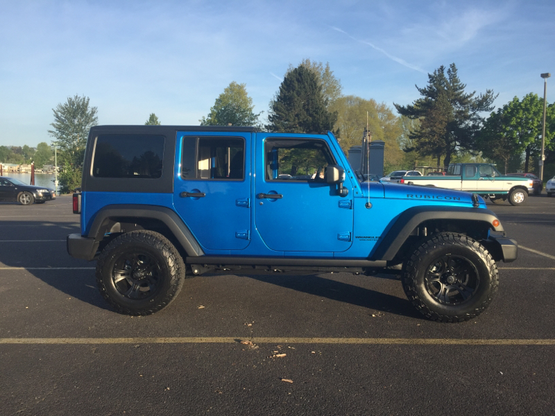

Tuff Country 2" / 1" level kit. 285/70/17
Service manager at jeep dealer advised me to do the 2/1 level instead of 3" lift with this tire setup. He is very knowledgeable in lifts. He knew I wasn't buying mopar lift from them so he wasn't biased in recommending what I needed he did recommend using a level kit with metal pucks instead of softer plastics.

Originally Posted by pdx-rubicon
Attachment 647981
Interesting that he said to go with metal pucks. At the 4WD outlet, I also got a recommendation to go with the leveling kit, but when I asked about metal vs. plastic, he said to go with the plastic.
I've got 40K miles on my TF leveling kit and also no issues to date.
