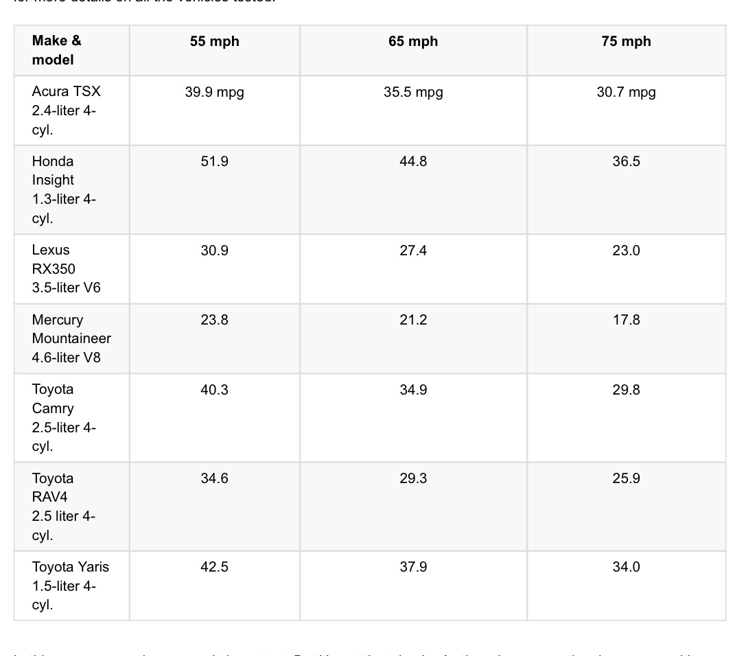

Take a look at the mountaineer data from consumer reports. Compare the 55, 65, and 75 on a percentage basis. 55 to 65 drop by 11% while 65 to 75 drops by 16%.
