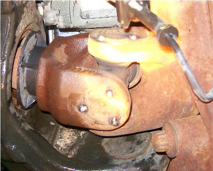

Look at the front axle close to where your tire is underneath your jeep. Where the C on your axle end is, there is a shaft that comes out and has a u-joint on it . I'll look for a pic.
Old Jul 5, 2009 | 10:42 AM
mkjeep's Avatar
Posts: 15,665
From: Hammond Louisiana
This is one with the caps tack welded. These caps have been well known to come off and cause axle damage.
Attachment 26476
i dont have an issue with that, but have read that many guys and gals do... ill be checking mine when i get a free minute

Nope, those are good. Anything else?
