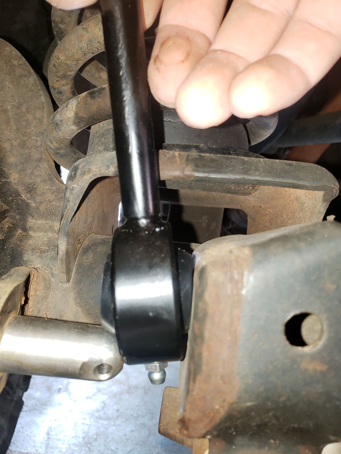

Needing help with sway quick disconnect not sure which thread to join, i bought tera flex 0-2.5 inch quick disconnect i try to hook the passenger side up and there not enough room between the stud and the bracket welded on for my track bar that i assume is factory has anyone had this im stumpped spent alot of money on end links like to use them since my facotry ones broke there physically not enough to even get the end link between it to slide onto the stud.

I thought the Teraflex kit used a bracket to relocate the lower mounts, and they should point to the passenger side of the jeep?

i didnt see no bracket i will have to go back and look bought full kit looks as everything came with it and the studds are in as the direction video shows if thats what you mean. Only thing i think with relocation bracket i think the end link would be to long if im not mistaken

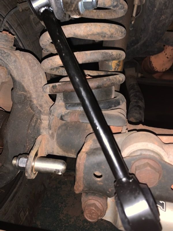

Something isn't right with the picture there. I've taken a picture of mine for you to compare. My studs are roughly 1.5" and there's 2 3/4" (roughly) of space between the face of the sway bar bracket and the track bar bracket. We can see you've got a lift on it with the bumpstops and it looks like someone has welded C gussets in place....maybe they relocated that track bar bracket or the studs are simply too long. On the JKS, the stud for that position isn't fully rounded out like what you're showing, it's cut at the correct length to get the link on plus a clip- no extra leading angle for lining up.

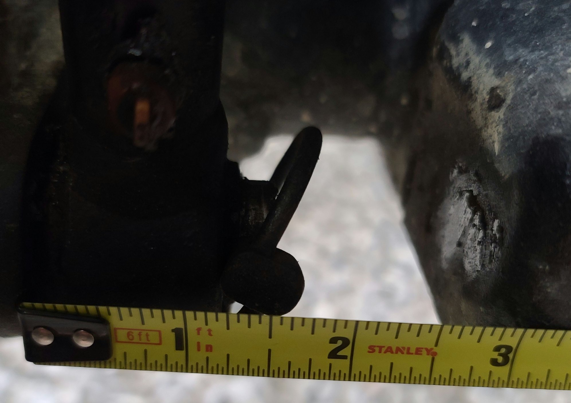

awesome ill have to do some measurements see about another kit but it has thrown me for loop i dont seem to see where anyother welds have been
Some better photos showing my issue

measured my teraflex studs they are about 1inch 3/5
