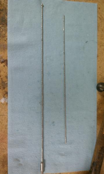

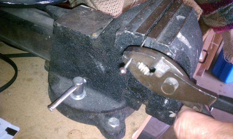

Default No need to buy antennas

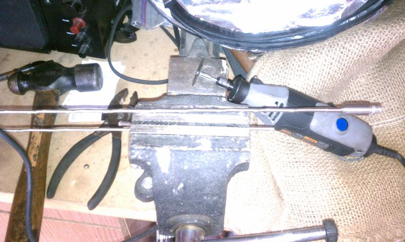

Clamp upper half of antenna in a vise. Use pliers with radius to go around the antenna, but smaller than the ball.
Tap the pliers with a hammer to coerce the ball off of the mast.

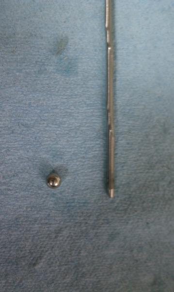

Cut the mast to your desired length with your favorite cutting tool.

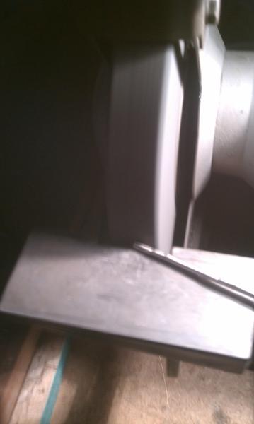

Taper the new end slightly.

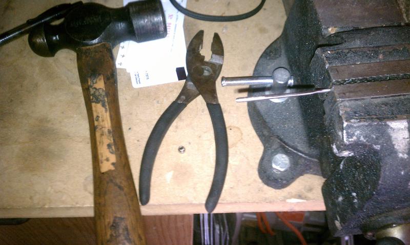

Apply a dot of red loctite to make you feel better and provide some lubrication, rest ball on bench, tap lightly on base to press ball back on.
