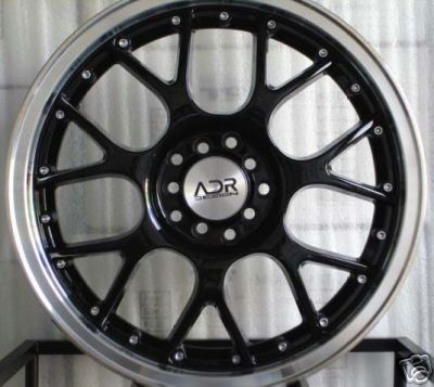

ok well i talked to them , tires delievered .com and they claim that is the way they are all being drilled now. from the manufacture wheel pros . ??? i cant believe that they would do that they claim the center cap covers the mess ? im tryiin to call wheel pros and see if this is true. i dont want them even if is true . i would never have ordered them if i knew this is how they come. and i being crazy here ?

NO WAY . No wheel should be drilled like that.
Send em back!!!

Told ya.
A lot of wheels are like that now so they will fit various bolt patterns. Ive seen it a lot.

yeah ive seen mulitpattern ones also.. but not like this with metal splinters and holes brecking into other holes . these just are not right !! i think the place that sold them bought blanks and drilled them themselves and did a very BAD job of it .

Send them back and get your money. Thanks for letting us know about the problem. I won't order from those guys now. Also thinking about KMC's, and will check bolt pattern (how they get it) before I order.

I would already be on my way to UPS with them, there is no way i will believe they havent violated the structural integrity of those wheels. holes into holes? wow, that is just plain BAD
Exactly, this is what it should have looked like, and not that half assed drill job.
