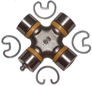

TW u-joint
Spicer greasable
Spicer non servicable
