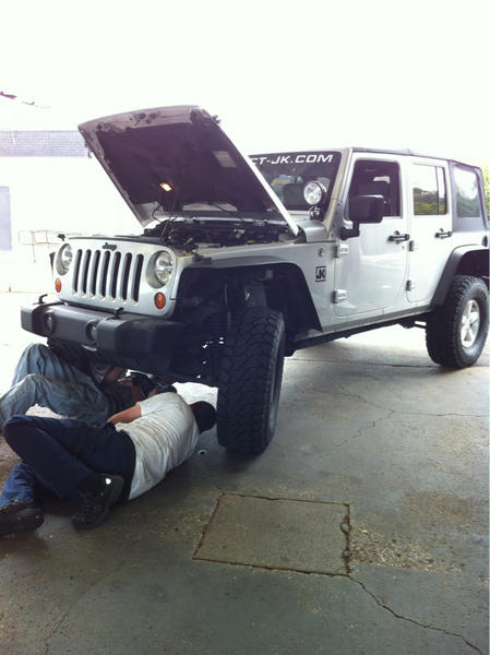

I'm at a loss. I have 2007 JKU and have had it since Dec of last year. It uses oil like nothing I've ever had before. It don't smoke and I never see oil drips wherever I park. I checked the oil Sunday (3 days ago) and it was about half way between low and the bottom of dipstick. Today I stopped by the shop to have a lil added and they said "you have no oil at all showing on the stick". They showed it to me and sure enough- none. Here you can see them under my Jeep checking it out and cannot find a leak anywhere. I've heard some Wranglers use oil and it's somewhat of a phenomenon. Even the shop guys were stumped. What's a reason for this? Y'all out there know more than anybody else. FYI- IF there's a thread on this I didn't see it searching on my phone- i told them to go ahead and change the oil so I'm in the waiting room writing this.
