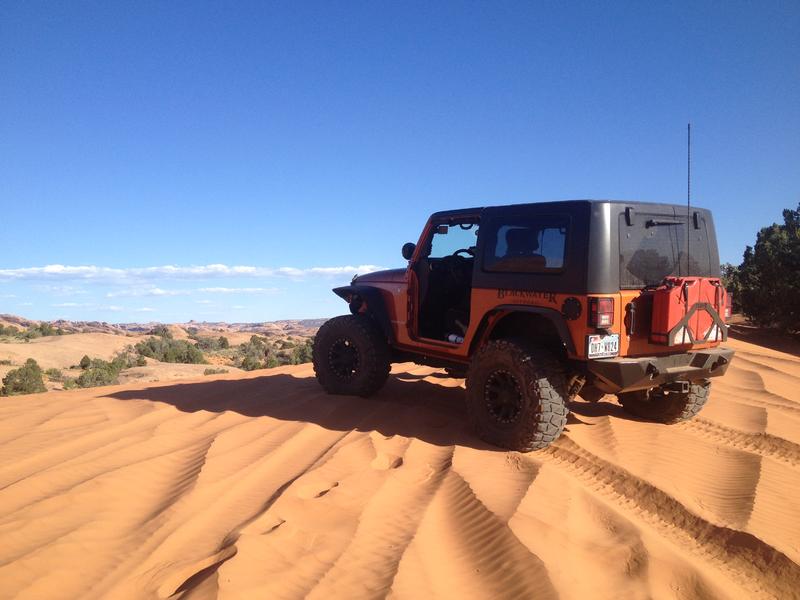

This is a 3.25" lift with 35" mud grapplers

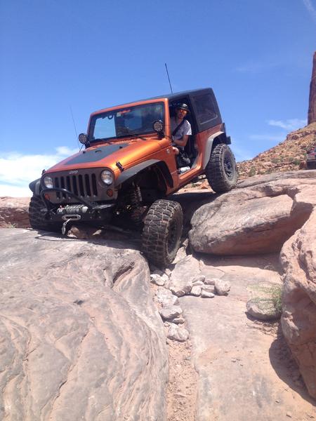

And this is a 2.5" lift with 35" mud grapplers and flat flares

Do you have any problems with it? Or anything you have to correct? I have the 3.6L with 3:73 gears, a Dana 44 in the rear and a 35 in the front.

Did you need new drive shafts?

As far as the ride height goes, no i havent had any problems. For about a year i had the stock 3.73 gears it was ok, but a also have the 3.8L. When i got a programmer it livened up some, but when i regeared to 5.13s it made the biggest difference i thought. And to answer your question about the driveshaft, no i have not changed them out and i havent had any trouble from them sense i put the lift on, and that was about 30k miles ago. The only thing that has happened is the front driveshaft boot tore on me, but that normal if you wheel your rig. and it happened at almost this momment.
