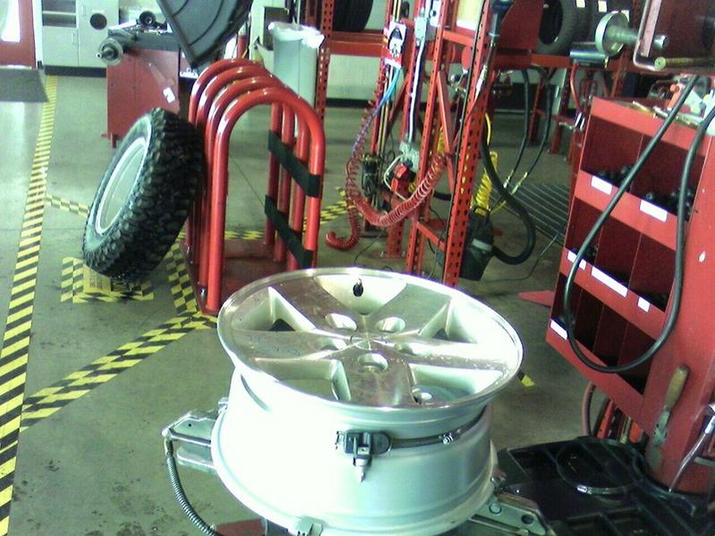

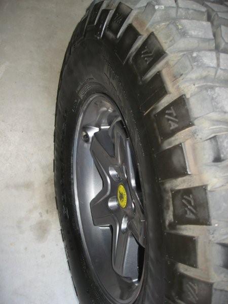

Problem solved.
iscount Tire banded the sensors WAY cheaper than a AEV Procal. Used shorty rubber stems so they stay tucked in where I imagined them to be in the first place. No TPMS dings or light with highway tire pressure.
Highly recommend have the sensors banded. This picture is not my tire/wheel, but it is the same band kit:

Here's the result:

Well we don't have a discount tire over here in Idaho so I went to Les Schwab and spoke with the manager Brad and he first said "No you will need to go to the dealership to get the sensor" So, then I explained in detail what was happening and he said "That's not a very good design for a off road vehicle, lets see what we can do..." So he sent me out to the shop with one of the techs and I showed him your picture. he said "I can't see or figure out how they mounted the sensor to the band" so we cut a grove in the plastic valve support on the senor and removed the stems. we then placed the sensor in the grove of the wheel and placed a band over the sensor. Works perfectly!
But it ended up costing me $108 for bands, rubber stems and labor. But that is still cheaper than replacing one sensor from the stealership!
There's a bracket that comes with the kit. The band slips through the bracket and the sensor just screws in like it's a regular valve stem. However, it looks like your solution works too!
