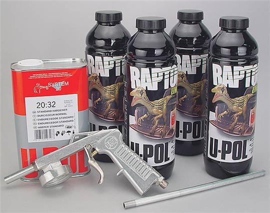

1. Look into this stuff, better for this application than heculiner. And just cost around $100.
2. DO NOT go to bare metal, just scuff the paint to cause grooves or ridges so the liner will have something to stick to. Paint is a moisture barrier bed liner is not.
3. Plan a whole day for prep work, it will take it. Spray the next day when you are fresh. Spray 3 different coats. Wait till previous coat is tacking to apply the next, you want them to adhere to each other but you do not want running/dripping.
4. Use something like this.
5. After you scuff the entire surface clean to remove all loose particles. With soap and water and possibly acetone if you want overkill. Don't forget masking tape and poly to protect from overspray.
If you decide to go with herculiner the prep is the same. If you go roll-on just wait longer between coats so the liner has more time to dry letting the first coat stay in place when the roller passes over it.

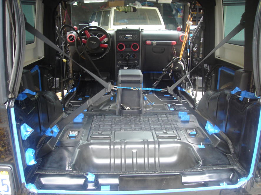

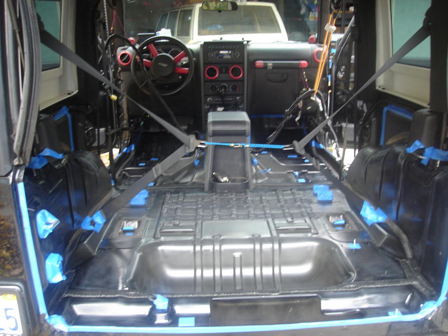

I picked up the one gallon kit at autozone, I had 1/4 left over.I did the entire tub up to the lip of the hard top and the inside of the gate door. I also did the lower door sill between the 2 seams for the front doors cause they always are getting scratched. Once the first coat is no longer tacky to touch start the second coat (depending on the tempature outside it could be 1-3 hours after the first coat is down).
2) How much do I have to prep the tub of the JK? Do I have to get everything to the bare metal? Details, please.
I bought a 3 pack of the green kitchen scrub pads. They worked better than the one in the kit. You dont need to go to bare metal, just need to scuff it to get rid of the shine.
3) Curious. How long would the sanding prep probably take to do the tub of a 2dr JK?
After pulling the seats (they are torqued to a billion pounds), carpet, trim, lift up the wiring and pull the drain plugs. I taped up the outline, drain holes and whateverlese I didnt want the liner on. That took about 2 hours. The scuffing took me probably 1-1.5 hours. Once your done scuffing everything up, vacuum up all the dust and dirt. When your done vacuuming wipe everything down with acetone, paint thinner or MEK. Now look to see if there is any spots that might need to be rescuffed (if so rewipe with the cleaner you use)
4) Is there any specific sander I should look into purchasing or borrowing that will help get the prepping done faster and/or more efficiently?
You dont need to get a sander to scuff it ( you could use it as an excuse to get a sander though)
5) Anything else I should do to properly prep my tub before applying the Herculiner?
the better the prep you do, the better the end product
Make sure you wipe it down with acetone, paint thinner (the directions in the kit will help a lot). Make sure you get some latex gloves and maybe another 2" or 3" paint brush. The worst part of the whole job was removing the tape after you finished the second layer (dont wait for the second layer to dry, pull the tape as soon as your done).
If you can find it, there is also a UV protectant from herculiner that you apply on top, get it if they have it, to keep it from looking like powdery grey that a lot of trucks get from being out in the sun.
Here are a couple of pics before and after

i have used the upol raptor kit on two different vehicles.
one was a tj and the other was one of my work vans. its held up way better on the tj than the van. i do however think that the reason it hasnt held up on the van as good is because i didnt get the raptor on thick enough. plus it hauls cabinets everday.
on the tj it has held up pretty damn good, no complaints.
just so you guys know the raptor liner is rubbery like other systems out there. it dries really hard and textured, stuff will slide on it.
shaun h
