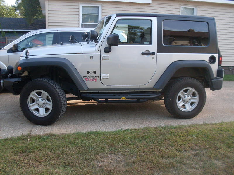

Here is the pic body lift with leveling kit...
With side steps
