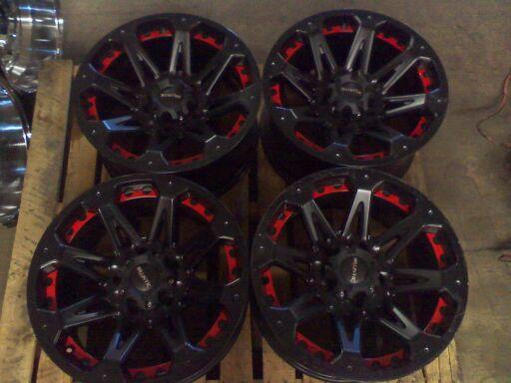

If a wheel doesn't fit in your stock spare tire carrier, it's not going to fit the jeep right? There's a guy trying to sell me wheels but I tried it on the spare holder and it didn't fit but he said that they are my jeeps lug pattern
If it dont fit the carrier, it wont fit your JK. Your JK runs a 5x5 lug pattern. If the wheels are from or for a previous mnodel (YJ or TJ) Jeep, the pattern is 5x4.5.

Yeah that's what I thought too, this guy thought he was gonna pull one over me lol. Thanks

If the deal is good enough, you can buy some spacers like spidertrax that will convert the lug pattern over.
What do those run for?

He's selling me these for 375 for the set
<img src="https://www.jk-forum.com/forums/attachment.php?attachmentid=336459"/>
The spidertrax run about $50 a piece. I think Rancho makes some around $30-35.
