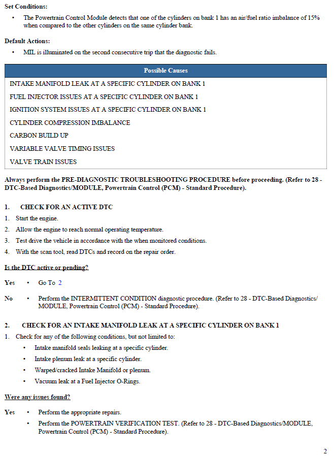

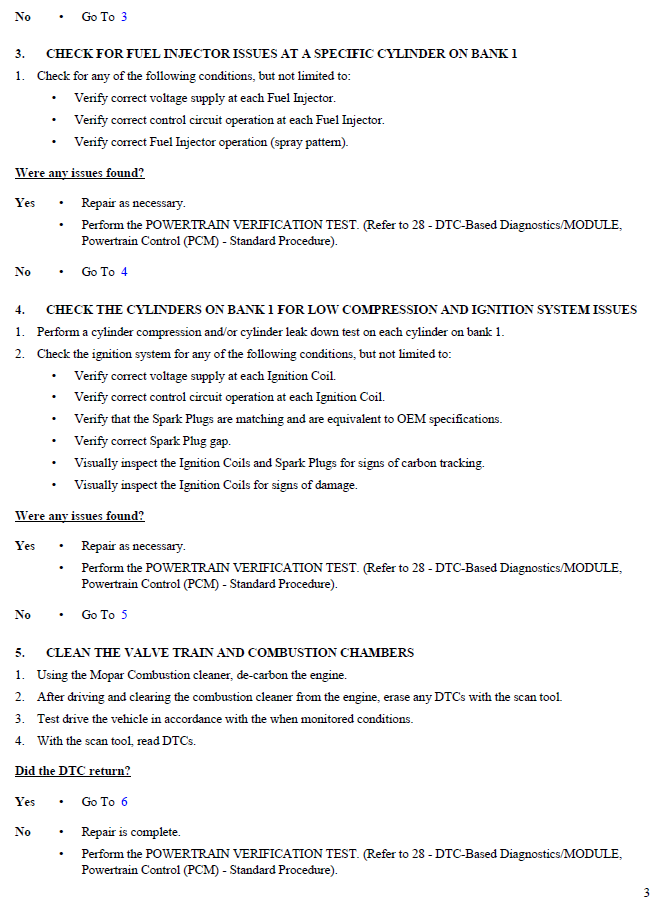

This is not a code nor issue i've ever had experience with, but going to attach the pages from the service manual so you can see the logical troubleshooting (short relative to many codes) -
