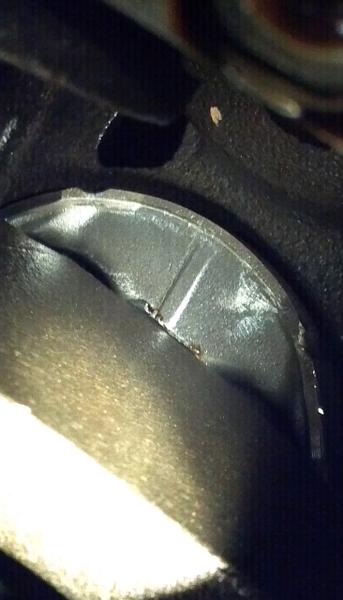

I was wondering if I can pull the heads off and pull pistons out to replace the rod without pulling the motor out. I have an 08 wrangler that had a knocking noise. I pulled the oil pan and looked up underneath and it looks like the crankshaft is hitting the drivers side rear piston. Is this something I can repair myself or should I take it to a garage? Any help would be appreciated.

Old Sep 6, 2012 | 08:32 PM
shaggy591a's Avatar
Veteran: Navy
Joined: Apr 2010
Posts: 236
From: Renton, WA
The only way I know how to remove the pistons is by hit it with a stick or something from underneath the piston. If you have room under the jeep to do that you might be able to do it without removing the motor.
Old Sep 7, 2012 | 05:08 AM
larythebaker394's Avatar
Former Member
Posts: 25
I would take it to a garage. There will be other residual problems associated with a disconnected rod.
Old Sep 7, 2012 | 11:55 AM
dkfrank78's Avatar
Posts: 55
From: Conroe, Texas
You should take it to a garage, then engine needs to be out of the jeep and inspected for other issues.
Old Sep 7, 2012 | 12:28 PM
buellrydr's Avatar
Posts: 12
From: Las Vegas, NV
I think I might try and do it myself. If I get to a spot that I know I won't be able to do it anymore, it has to be towed to a garage anyways. Its worth a shot if I can save a little cash
Old Sep 7, 2012 | 12:45 PM
Bonedoc's Avatar
Posts: 1,053
From: East Stroudsburg, PA
I would just plan on pulling the motor. As stated by other posters you will probaly have other issues to address.
