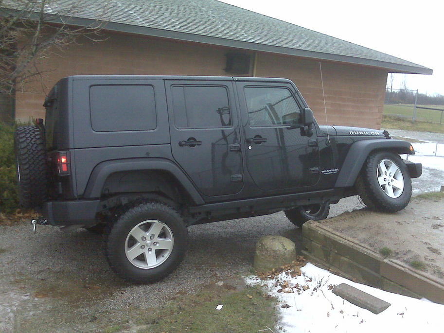

just a small ledge with a rock in front to help me the climb, so you think just slowly letting the clutch engage would just crawl up that? 4hi or 4low?

absolutely 4-lo. maybe a small amount of throttle to get up that. You'll get better at it the more you mess with it. Done this a couple times at my job....that sucker will crawl! Pure vertical concrete there.
Another question is did you have the front sway bar disconnected? looks like you did but just asking

yah i had it disconnected. thats sweet pic

just went out to fuck around on some loading docks, now i see what you mean, even engaging the clutch away from your object a few inches and braking hard right before it so you just nudge up it works great to, i was really surprised how hard i can hold the brakes and how slow she goes untill she wants to stall.
