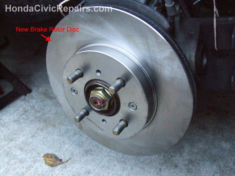

Left: Rotor damaged by exposed screws in worn out brake pads
Center: Heat damaged rotors resulting in warping and cracking
Right: New brake rotor

It depends on your driving style really. Highway vs. city. More city driving usually means rotors replaced more often. Odd you had to do rear brakes before front brakes. Majority of braking comes from the front end. But anyway, signs of failing rotors are a low grinding noise when braking or a wobble in the steering wheel/seat when breaking.
