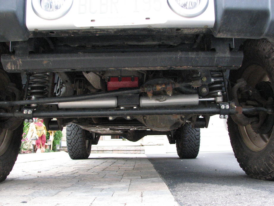

I recently installed the 3.5" lift and dual steering stabilizers.....I just came back from 2 days of trails and noticed that when I flexed my drag link adjustment collar smashed into the drivers side shock.....I called Rough Country this morning and they are sending me a new one!
I just need to ensure that I turn the adjustment collar around so that it doesnt hit my stabilizer!
They could have blamed it on me and not covered it....but they are sending out a new one......actually 2 new ones....as my friend had the same thing happen to him.
thanks guys!!!

Ok....here's the update.....I called Monday about the dented Stabilizer......I just got 2 new ones delivered to my door today. That is incredibly fast considering that it had to clear customs as well. It's installed.....I took my old one off and I'm glad I replaced it........it had very little movement with the dent that it had.
Thanks ROUGH COUNTRY!!!!!
Hopefully now with the collar adjusted it wont dent the shock again.....I will see what happens this weekend at Rocktoberfest!

I run their 4" with 2.2 shocks and the dual stabilizer also. Very happy with the lift, good ride, good flex for a lift and stock arms. However my shock gets damaged every time I wheel. I have adjusted the system a million times and can't find a way to keep it from hitting. RC's customer service has been very good to me also.
