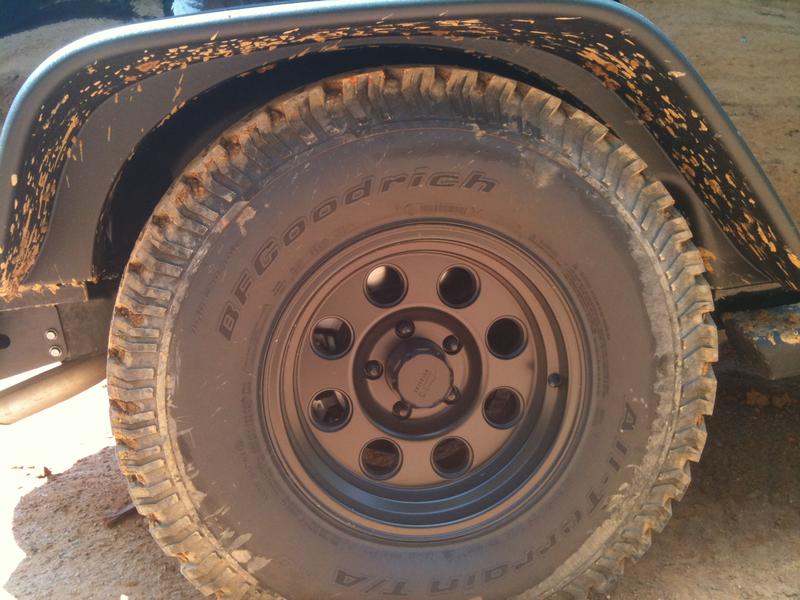

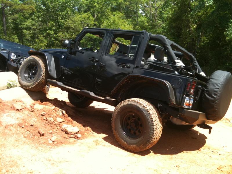

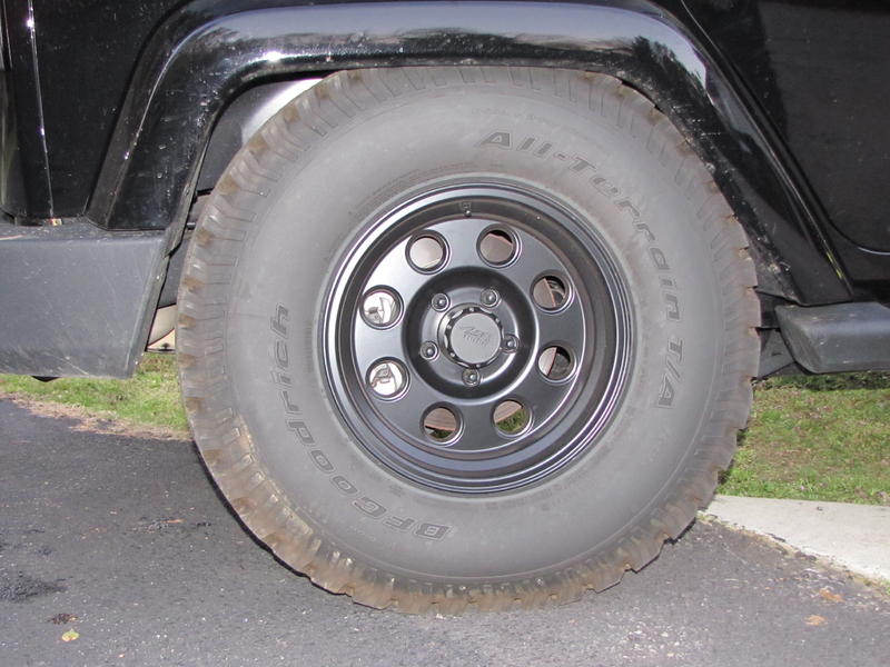

I went with BFG All Terrain A/T 295/75R16s with the stock suspension. They rubbed on that plastic front air dam / skid plate thing in reverse when turning. I took it off. They rubbed on the back fenders when trailing and mild flexing. I put on the TeraFlex 1.5" Performance Leveling Kit. Still rubbed on the trails. I added the Bushwacker fender flares - no rubbing now, but I can stuff the back wheels up in there pretty good on a full flex. I really don't think I'd go bigger with the current set up.
