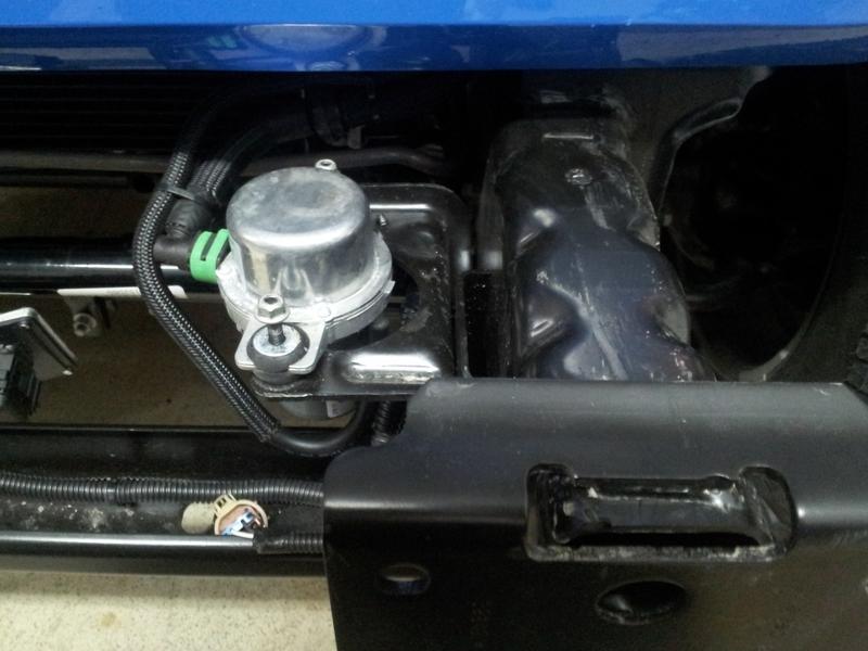

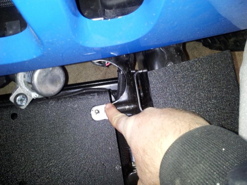

Bought a Smittybilt bumper for my Rubicon today. Running into an issue where a canister is in the way of new bumper. Has anyone else ran into this? The fix is probably to just recess the area out with a saw and grinder,but figured I would check here first.

saw a post that wayalife did on relocating it - gonna have to search

It's a vacuum pump that has to do with the power steering, I believe. There are some relocation kits out there.
https://www.jk-forum.com/forums/show...Relocation-Kit
https://www.jk-forum.com/forums/show...ighlight=87046
Hope this helps

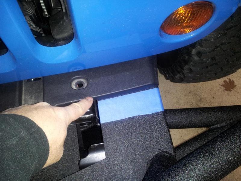

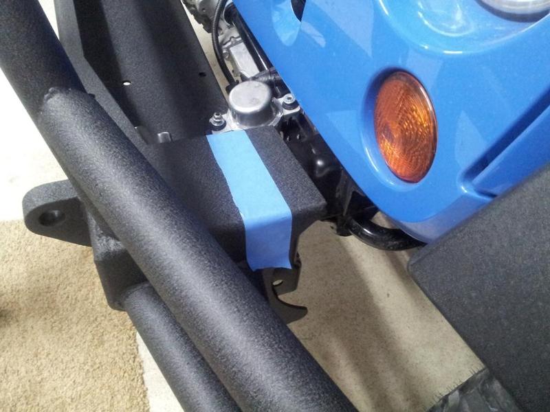

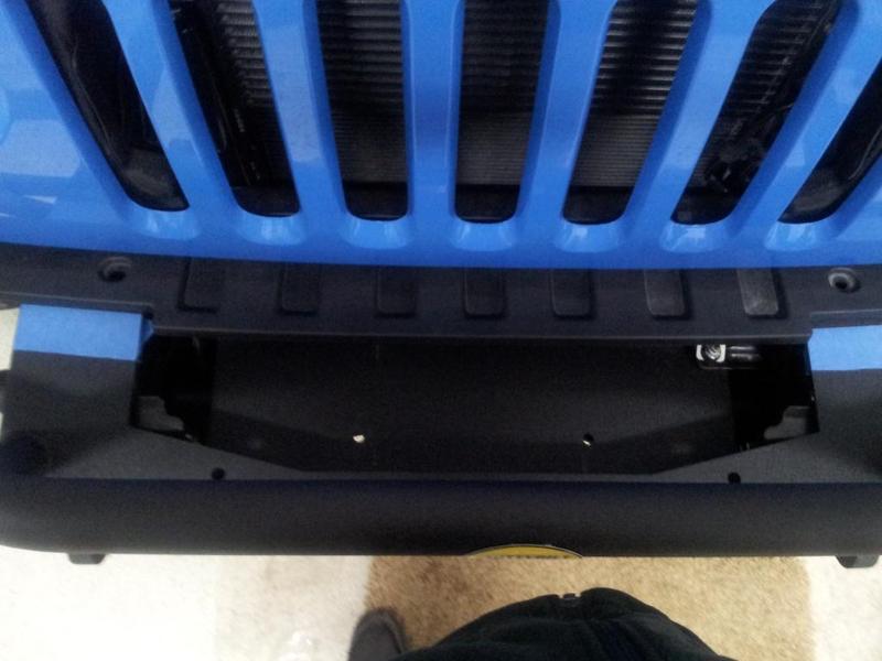

So....everything so far seems to bolt right up. I only have 2 bolts holding it on, as I immediately ran into the canister issue. I am a little dissapointed in the gaps. See pictures SRC GAP. The Blue tape is where I am thinking of trimming the bumper down to accomodate the stock plastic trim piece. The Idea is to fashion that to fill in the ugly gap.
Trim Soultion one: Trim the bumper back, and then set the stock plastic piece back. each side will hang over the side of bumper , but it should look..."OK" I would them trim around the bumper.
Trim Soultion two: Cut off tabs where my finger is pointing and screw or glue that little piece in places as a filler.
There is no Great solution and I dont own a fab shop to make anything cool.

Call smitty they just sent me one out no charge, fit and worked great over the one that way of life put on. just installed there xrc stinger. there instructions are poor but its 8 bolts so anyone can do it just have a helper mine was 73 pounds and help was great.

It was big but i also bought there rear tire carrier as well a there 10 k synthetic rope winch, once i set that girl in there i dont even notice it winch takes up all of that space.

My suggestion would be to relocate the pump and think about another bumper that you wouldn't have to modify to work on your Jeep. IMO you shouldnt have to start cutting things on a new bumper to make it work for you. Look into some other possible options.
