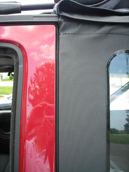

Anybody know how to solve this? This is my second JK and have had the same issue.

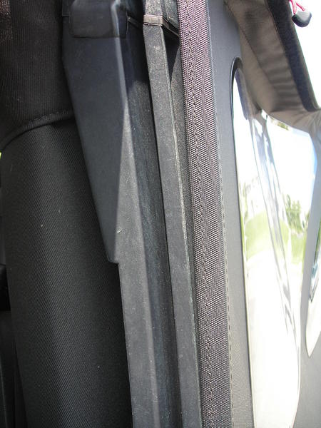

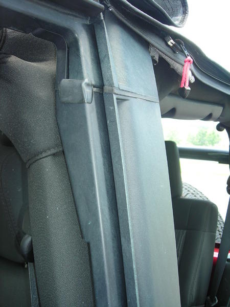

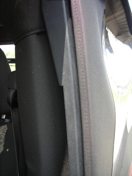

Hope this helps
