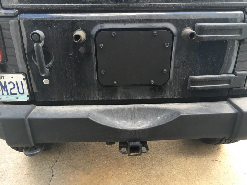

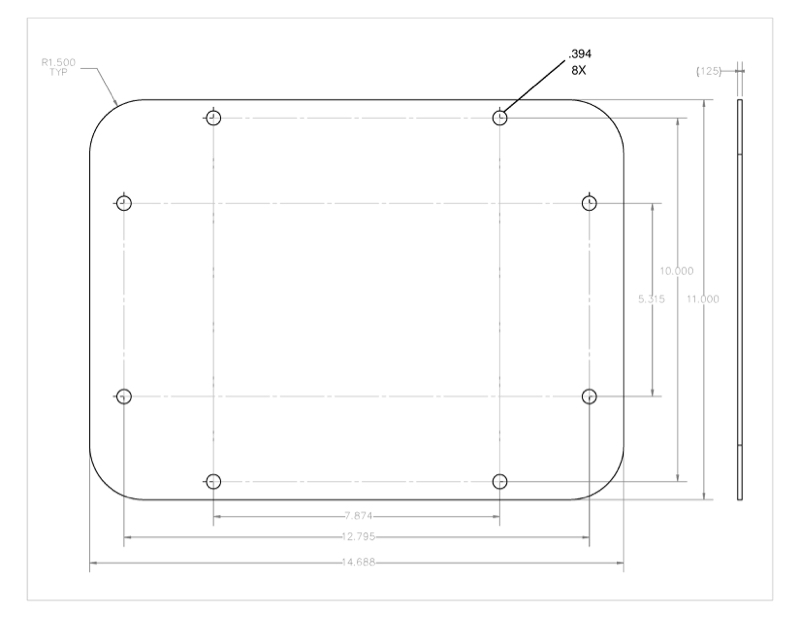

I used this template that someone posted on this forum. Sent it to a local guy with a plasma table. Had to drill the holes a little bigger but otherwise fits great. I used a couple rubber washer and a couple metal ones to create the gap for ventilation. I keep the spare flat, strapped in the cargo area now. Planning on mounting standing to one side somehow when I get the time.
