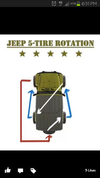

Here you go

It's okay to leave newer tires exposed for the most part. Covers are more for aesthetics these days. Older rubber compounds that didn't include goo to fend off UV and ozone would start to crack and break down if they were left exposed for a few years, but not really anymore.
I rotate in my spare using the standard 5-tire rotation designed for 4x4's. I rotate every 7k.

On that 5-wheel rotation, does that work for directional tires, too?
Used to have a dealership cover on the spare until I stripped it off and dropped it off one night on the dealer's doorstep. Like it better without

No, 5-tire rotation for 4wd does not work for directional tires.
