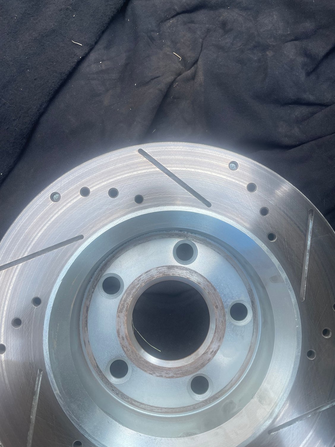

These are pictures I just took. Less than 100 miles on these new pads, rotor, and caliper. Everything I’ve ever read says pad “chipping” is a sight of excessive heat. I guess it could be slightly dragging , but it drives and brakes straight. 🤷‍♂️
