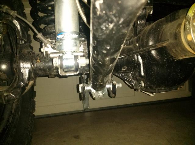

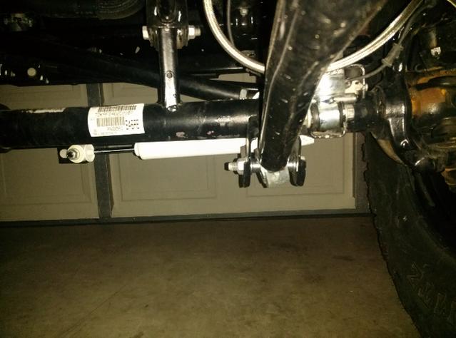

Took a couple pics for you guys. I think my entire axle is shifted to the drivers side a little. Would this be easy for me to fix? Or again, would this be easier for an alignment shop or the dealer to do? PLEASE HELP

quick adjustment of drag link to correct steering wheel, lengthen or shorten your front adj trackbar to re-center your axle. Both tasks are quick and painless.
