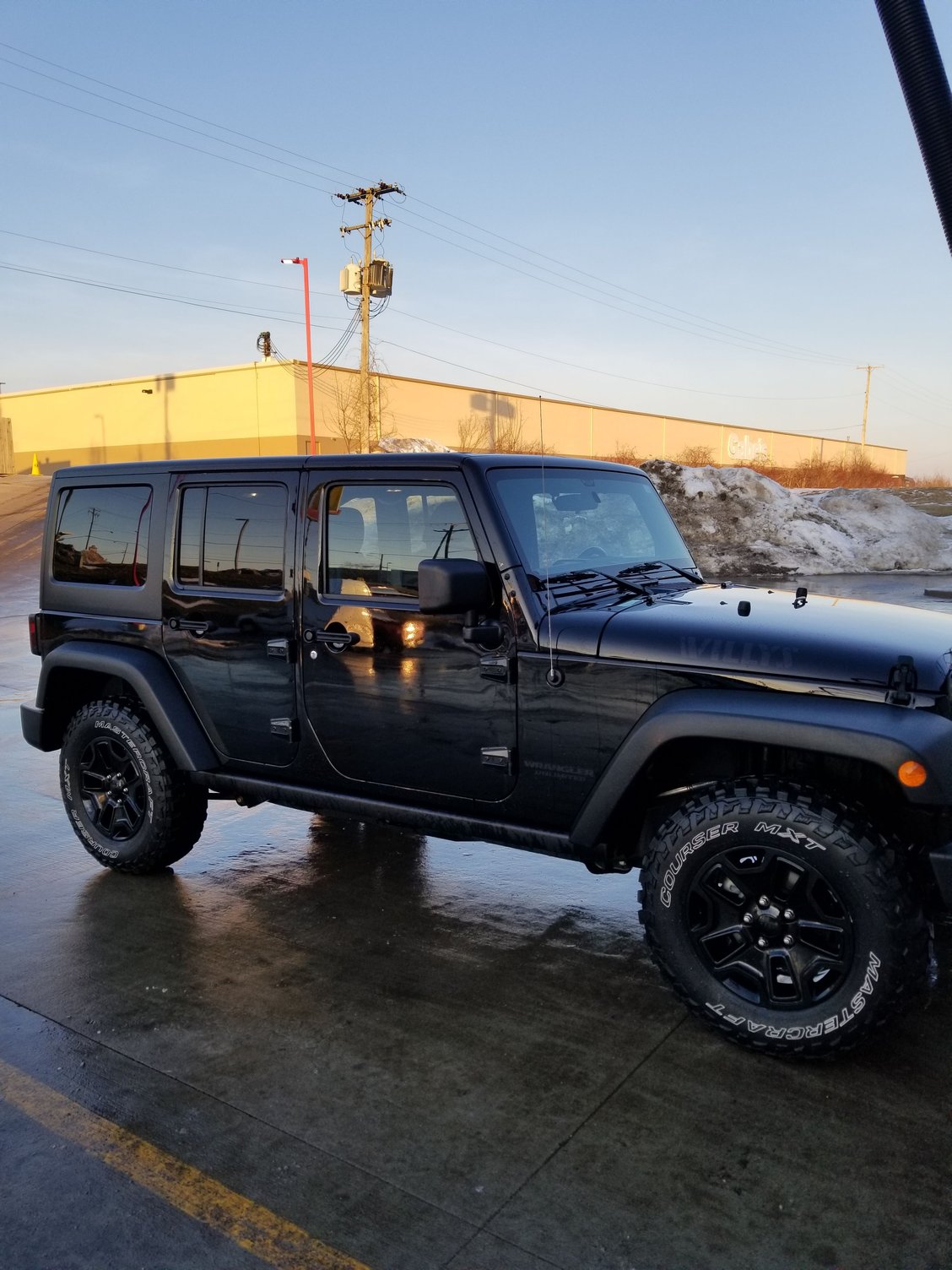

So I just bought a 2015 Wrangler and while I'm driving it keeps me busy. Seems like I'm always correcting the steering to keep me going straight. Like I'm driving on a windy day. Is this normal? Any way to fix this?

It looks like there is a lift kit installed. You will want to check to see if whoever installed the lift used anything for caster correction. Most lift kits don't include anything within the kit for caster correction, although it is needed after lifting. It would also be good to take the Jeep to an alignment shop and have them get your actual alignment numbers and then post them since steering related issues are often easier to diagnose after knowing the alignment numbers. Most likely cause based on your symptoms is that caster is on the low side of where it should be. To answer your question, no this is not normal.
This video explains what you are likely experiencing due to having low caster....along with some humor.
Keep in mind, this would be my best guess based on your symptom description. An alignment check would confirm or not. If alignment specs are ok, then it's possible you may have unbalanced tire related issues.
The most common methods used for caster correction are Geo brackets, Cam bolts, and replacement front lower control arms. If you don't know what these items are, then I'ld suggest snapping a pic of your front lower control arms where they attach to the axle and the frame and we can tell you what you have or don't have for caster correction.

That description seems pretty extreme for it to be low caster, but idk. I mean, I drove with ~2.8* caster for probably a year before I figured all this crap out, and although not great, it wasn't THAT bad. The only thing that comes to mind when pondering the OPs explanation, is what it's like driving right after installing new BJs that hadn't broken in yet......but I'd guess it's not likely previous owner replaced BJs on that right before trading it in.
That was my thought as well, especially considering it only looks like a 2-3in lift. Shops in my area do alignment checks for free, if adjustments are needed then that's when you get charged. It's worth at least getting a check done to gain some insight of what may be going on. I never heard of Mastercraft tires as well, but a quick search revealed they were a common tire sold at Wallmart. So the tires and balancing are suspect as well.
