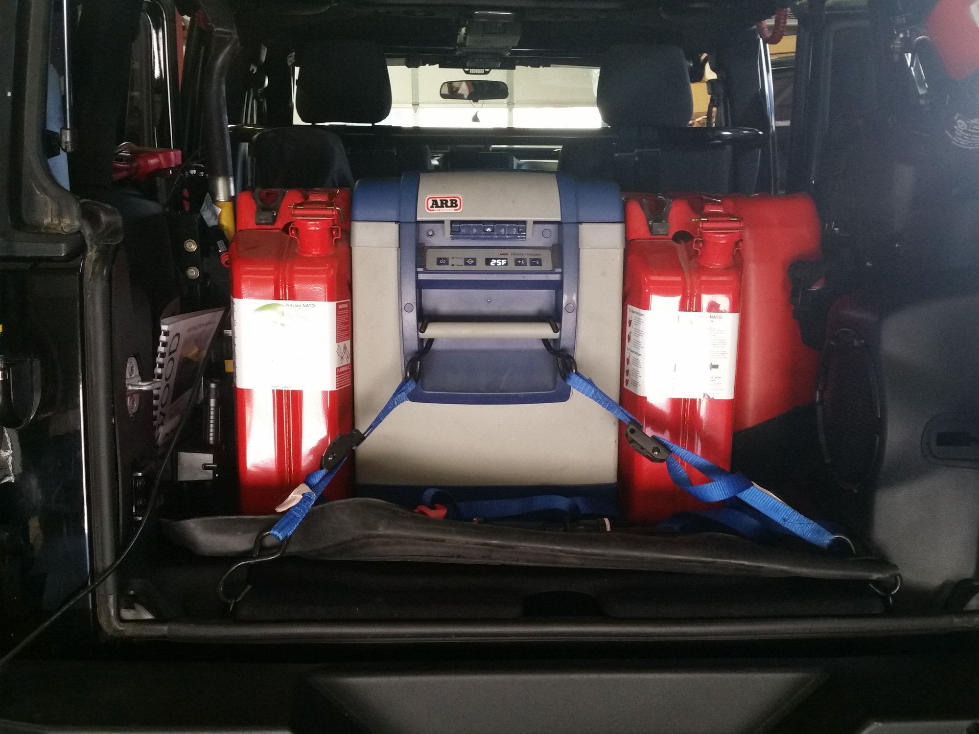

Here's my way of strapping things down.

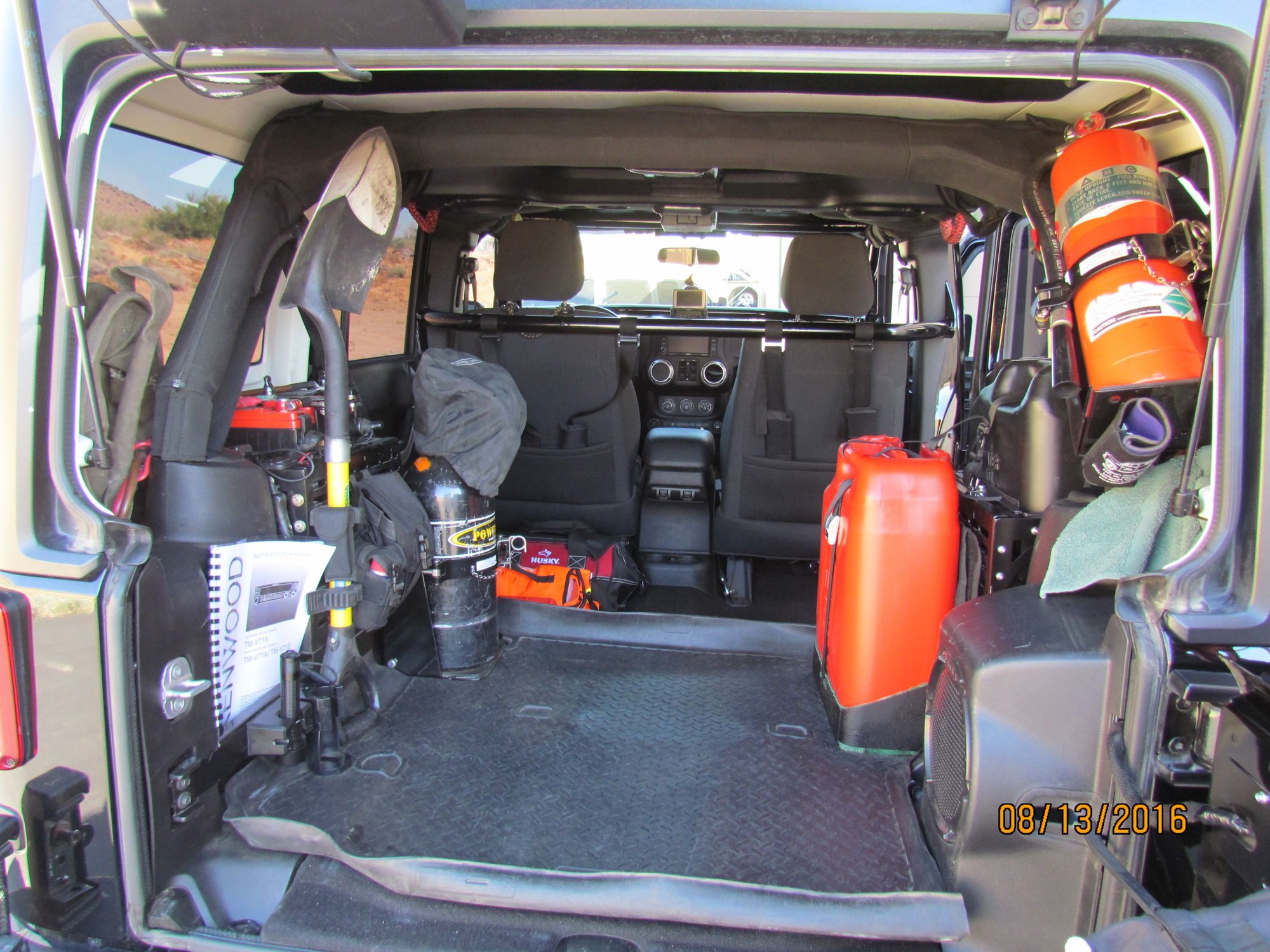

My way..

Originally Posted by caryt
My way..
can ya give more details on the different Molle panels you have? Thanks, steve
Old Apr 6, 2020 | 07:35 AM
caryt's Avatar
Posts: 378
Likes: 40
From: Smith NV
All are from Springtail Solutions Molle storage panels.
Left side I modded by welding in a steel battery tray for the Hawker battery.
I also bolted in a Kidde fire extinguisher mount for my 10gal CO2 tank, these mounts IMO are superior to any other mount for tanks.
Right side has a recessed pan which has my 2.5 gal Scepter water tank
I bolted in a old style GI 5gal fuel carrier base for my Scepter 5gal tank.
ARB is straped to JK hold down's.

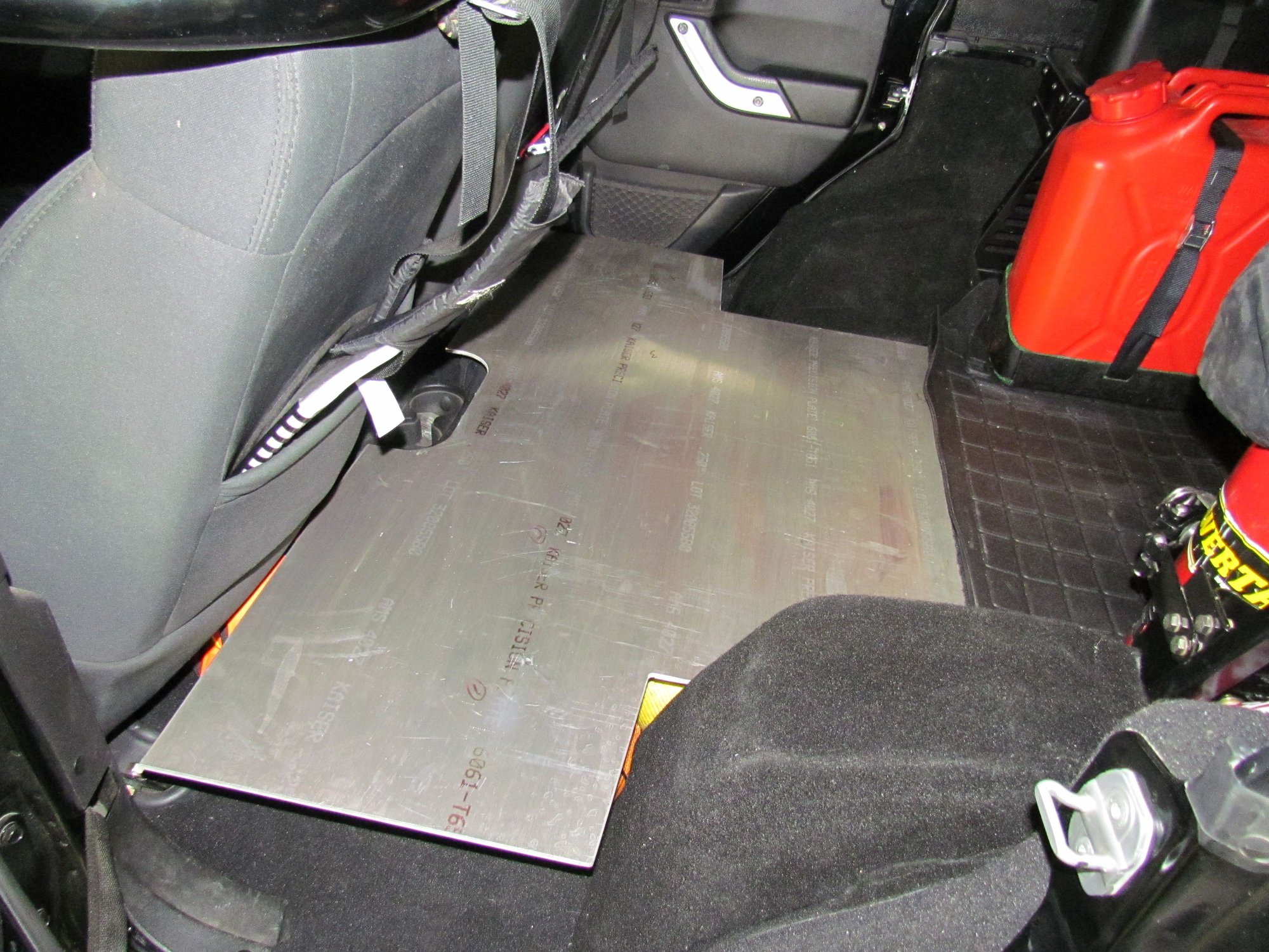

I just finished building my shelf to provide a flat floor out of 1/4" 6061 T6, Tig welded to 1/2" stand offs that are bolted into JK seat floor nuts. Need to find some rubber backed carpet to match
Note: I have since sold the 2ea steel 5gal Wavian gas tanks.... pure crap. I'm looking for 2 more Scepter's.
