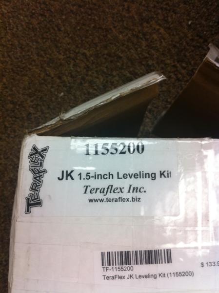

Thank you!
Guess what the UPS guy brought today!?!?
Can not wait to install!!!
