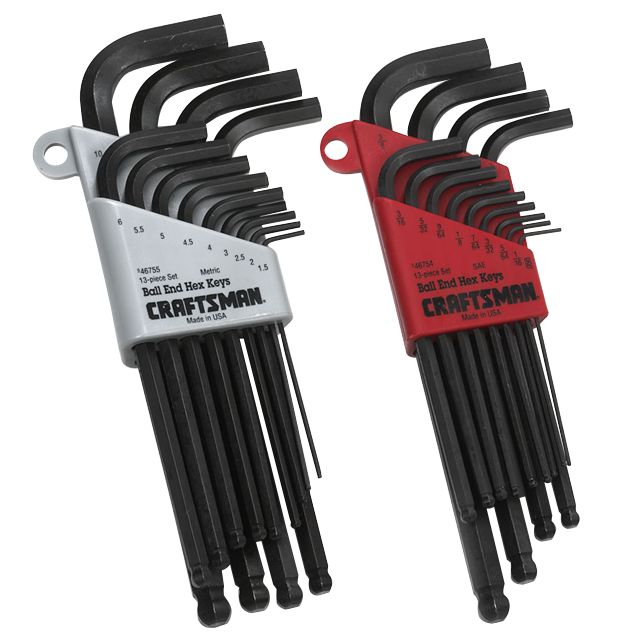

These are Hex Keys, or Hex wrenches, or Allen Keys/Wrenches, etc... to some people...Hex means 6 sided, like a hexagon, etc...so they are "L" shaped or "T" shaped bars with 6 sides....for fitting into 6 sided holes.
