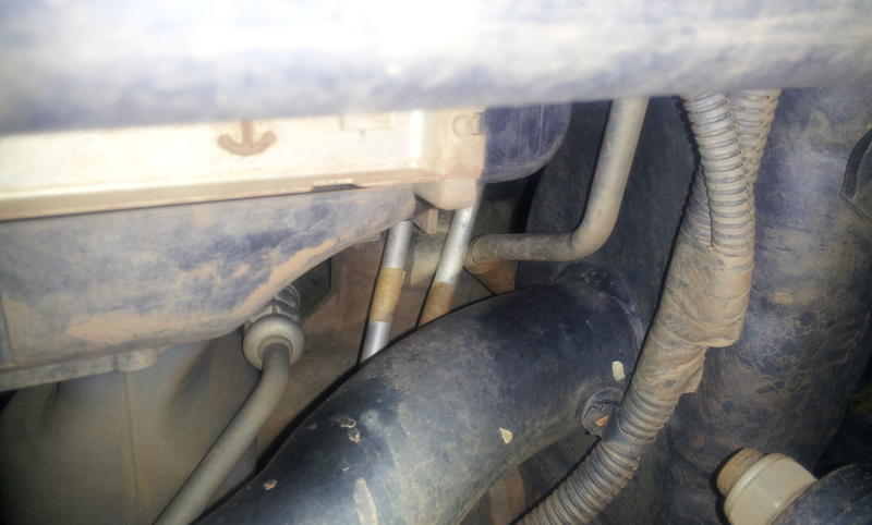

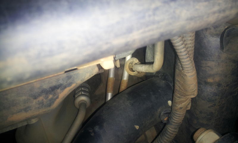

From: Mile High Colorado
Originally Posted by JK08MCS
What does this sleeve look like, have any pictures you'd care to share?
PS: I said it before, I don't let anybody screw up my Jeep but me
here is what I did, I just moved a rubber sleeve section over about an inch.
Before

After
