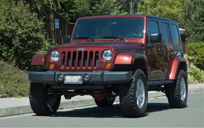

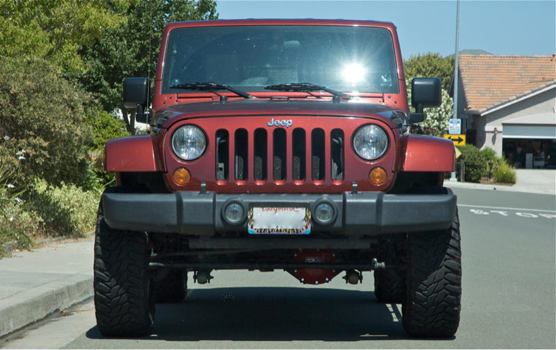

SME-Pics with stock wheels 275x70x18 Cooper STTs and spacers giving 4.5" of backspace. TF 2.5" coil lift.

If you don't use spacers, just adjust your steer stops to remove rubbing rubber on control arms.
