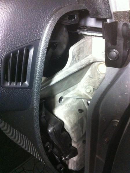

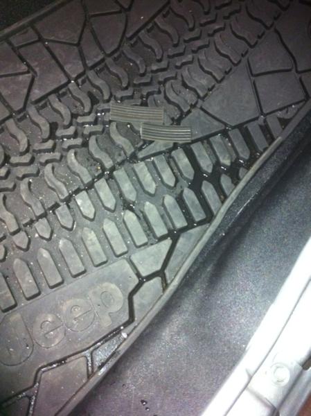

Know there is a tsb about the gaskets but dealership keeps saying it doesn't pertain to my vin.
I pulled the dash side cover and dry as a bone. Ran my hand all under the dash nothing! Stuck my finger in the hole at the a pillar its dry too. Still have a dribble from where they replaced my header gasket cause they said I messed it up putting the top on. Here's some pics. Any more ideas?

Dry hole and a dribble? You better go somewhere other than the dealership!
On a serious note go to the dealer and see if they have a water leak specialist that comes in a certain day of the week. Usually a tech will throw whatever at it or no problem found because they don't want to deal with it. I think the one we used to use (sublet) was called the Water Dr.
Not sure if your dealer does anything like that or not but may be worth a shot to ask.

Originally Posted by ludski
check along the door while its raining. to see if the seal is doing anything.
also, remember, when you open the door when its raining. water will drip in from the roof. fast.
That's why I noticed it. Went to the store jeep was parked in garage was in the rain about 15 minutes looked down there it was(passenger side just me door never opened). Guess I'm have to swap tops again and take it back to stealership.

Also it's wet on top of the slush mat not the carpet.
