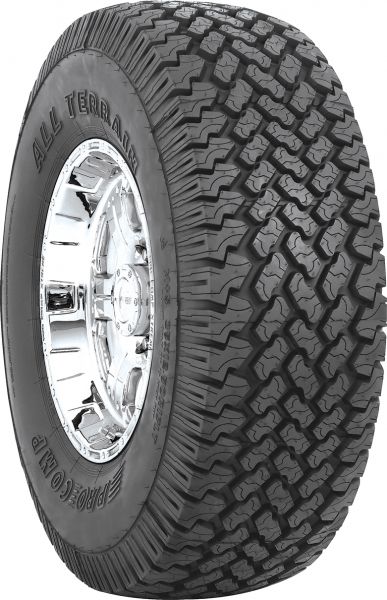

Example of a Pro Comp All Terrain Radial Tire that will give better ice traction:

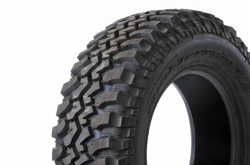

BFG Mud-Terrain T/A (no slits = reduced ice, packed snow traction):
