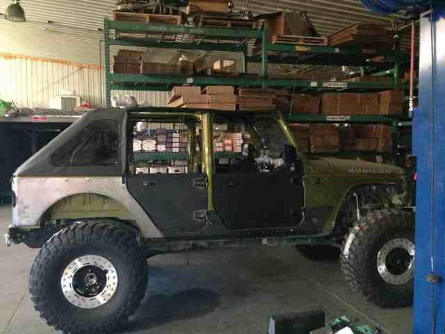

This rig is being built as a playmate for Rex.
TNT dual triangulated 4-link rear
TNT y-link front
TNT guardian bumper front and rest
TNT belly armor
TNT sliders
TNT side armor
York air
TR beadlocks 17"
Dynatrac 60 rear 5:13
Currie 44/60 front 5:13
Atlas 5:1
Wheelbase: 116"
40" BFG blue labels
Relocated gas tank (to give more belly clearance)
Not sure of shocks and springs setup yet.
It'll have a 2" full cage
4 corbeau leather seats
Strike Force Zebra trail doors
