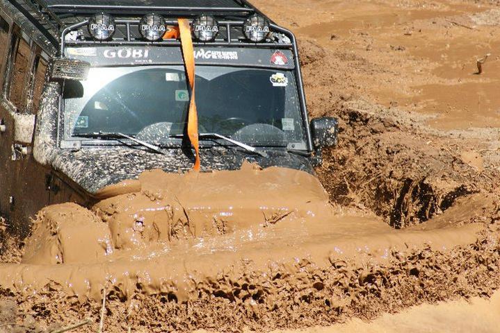

1. Remove Grill
2. Remove Oil Cooler Fan
2. Remove Radiator Fan Assembly
3. Hose Down Radiator from both sides until clear water comes out (approx 30 minutes of hosin
4. Reassemble 1, 2, 3.
But boy, worth the work!
Name:	duro al fango.jpg

It's most commonly called rinse and repeat!! Cool action shot!!

I have seen people do that and then complain later that the air conditioner is not getting cool or their fan is always running. Looks like you had fun and new what to do afterwards, outstanding! That is why I don't like the mud, it takes so much work to get it all off later. Guess the old saying is true, if you want to play you got to pay.

That's a sweet pic!
Actually, without disassembly of the rad fan assembly and backwards hosing, the fan would always be on. I have the rad fan swicthed, so the switch bulb turns on with the fan. Without cleaning it backwards, the fan would turn on with the ac, in the morning, doing 55mph's, whears with a clean rad it will not turn on at that time. No problems with the AC!
It was fun!
