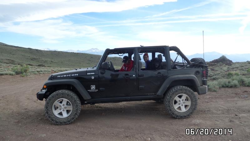

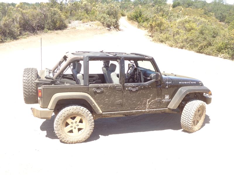

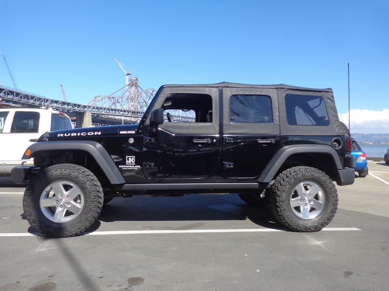

I have a 2008 Unlimited with 295/70/17 Nitto Trail Grapplers, essentially 33's that are about 11" wide. I have about 65K miles on them and they still have decent life left on them. They are good on road, not too noisy, and work great on the trails!
I have a 2.5 TeraFlex BB lift, and kept the stock wheels with 1.5" wheel spacers. Here are a couple pics.
Attachment 633938 Attachment 633939
Attachment 633940 Attachment 633941
