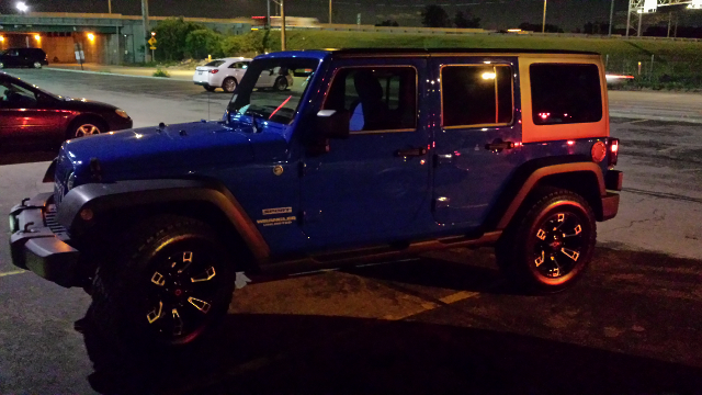

So I run the BFG All Terrain KO2. I am very happy with the ride and the look of the tire. They are really quiet. As far as size. I have 285/70/17 on a -13 off set wheel with at Teraflex leveling kit. I think you are fine running up to a 33 on stock or after market wheels. As long as he is just going to do street driving and minimal off road.

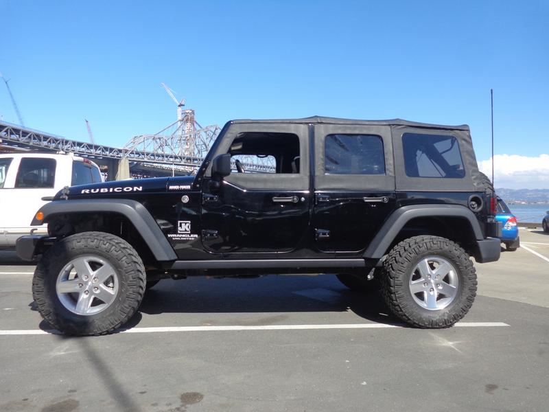

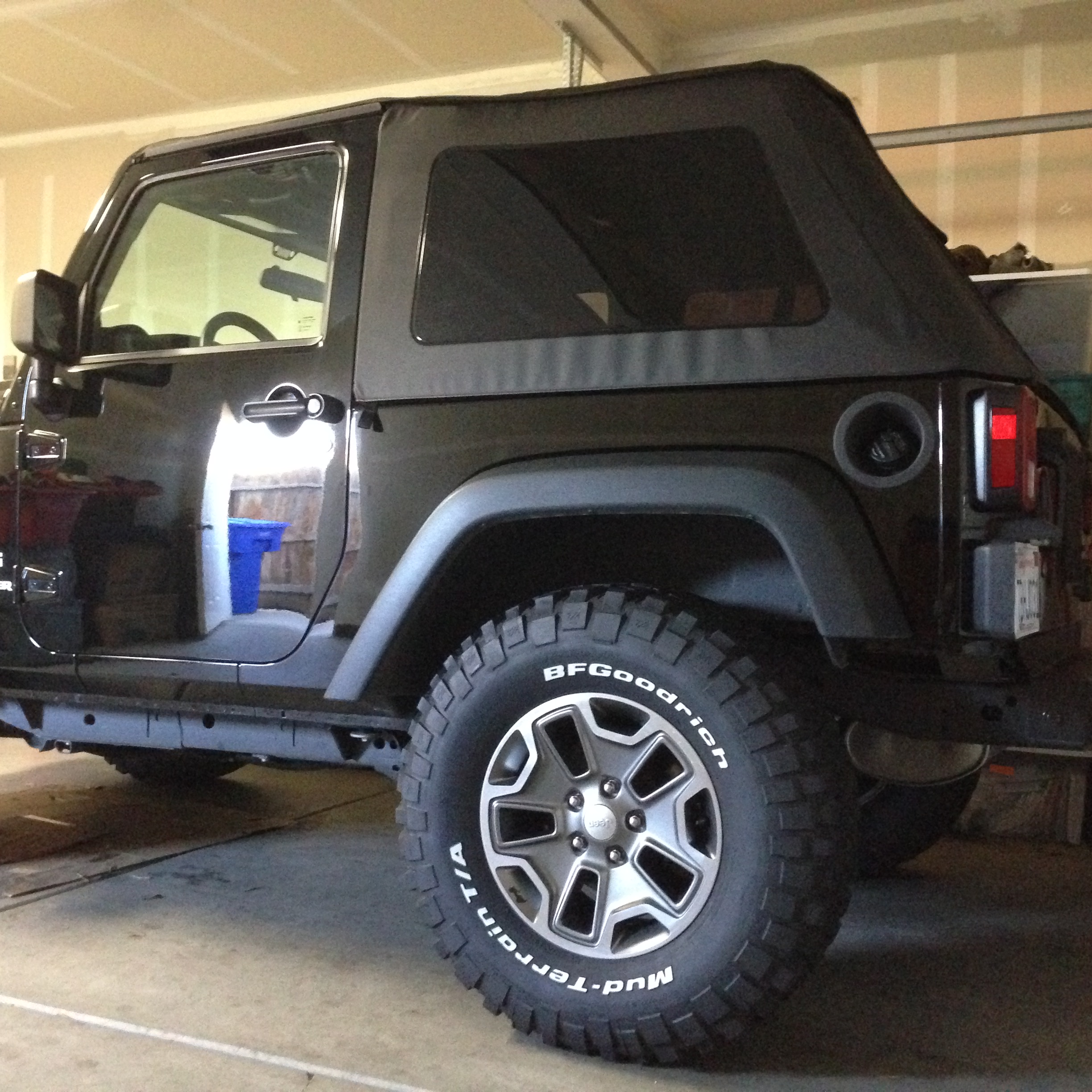

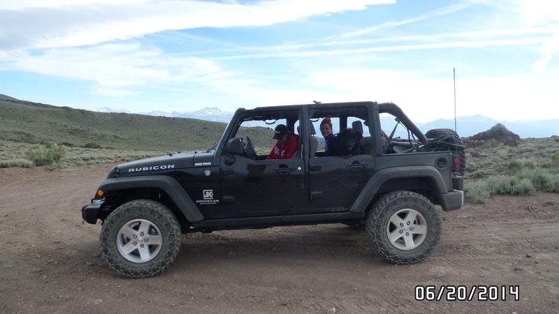

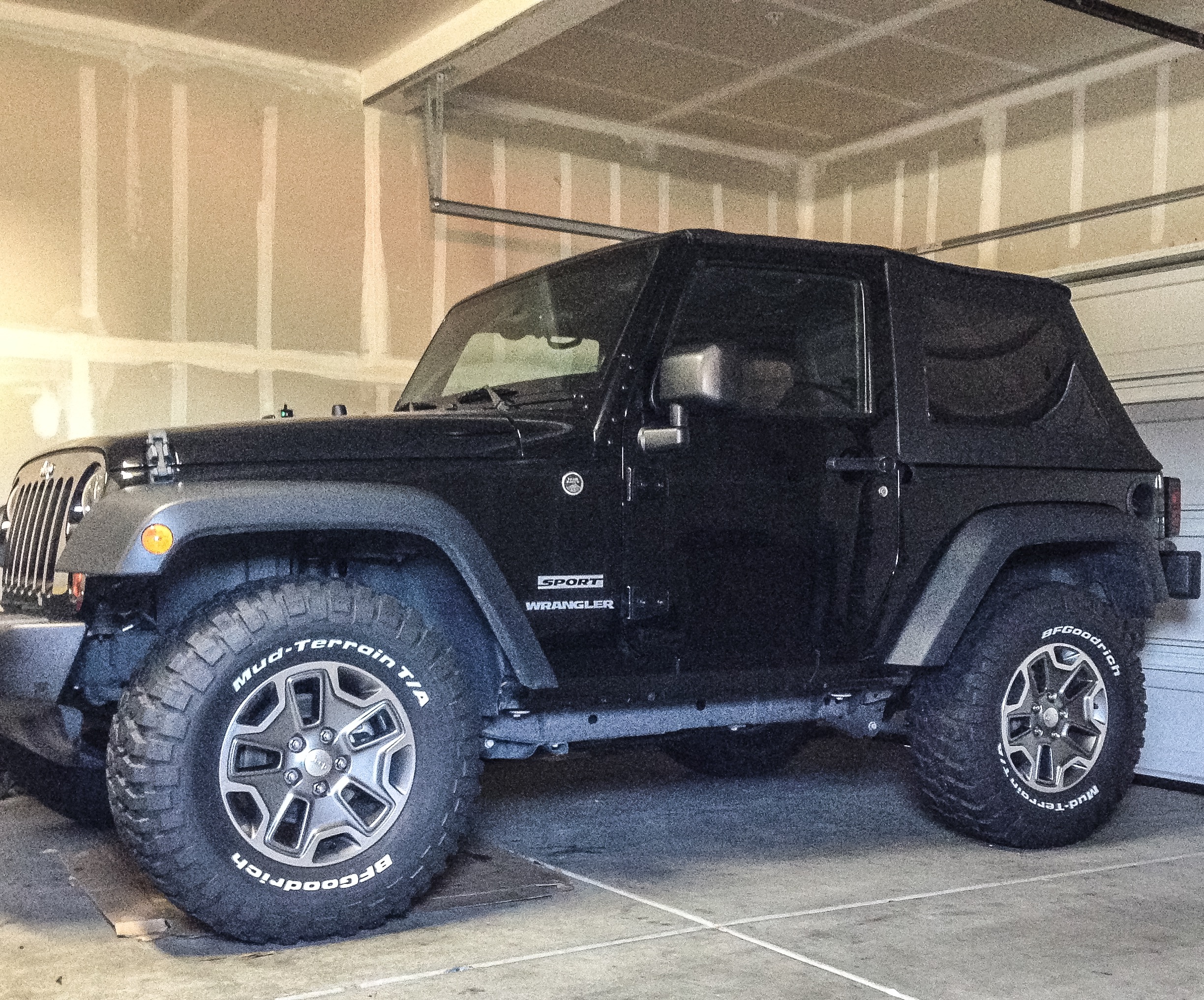

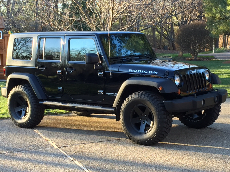

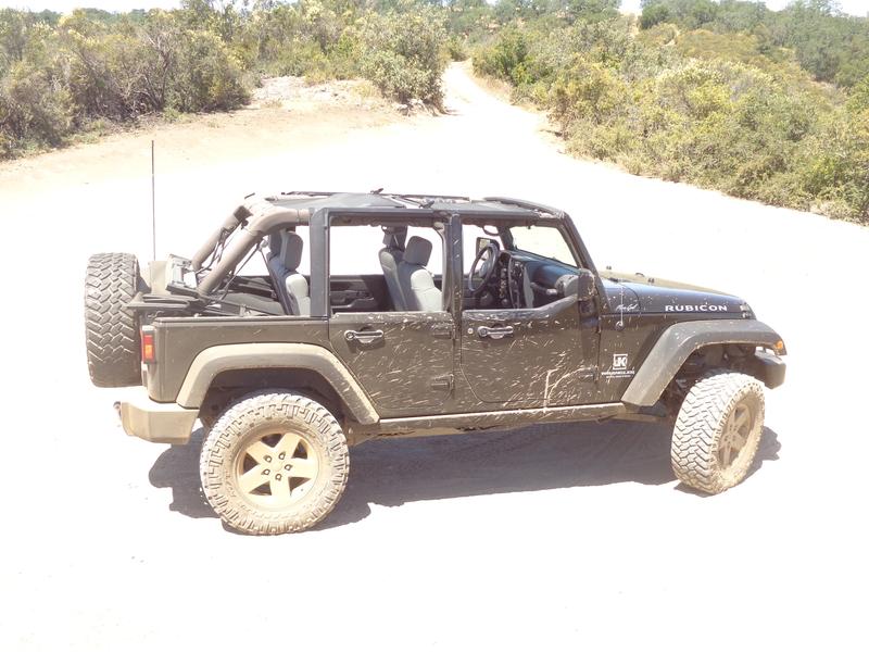

I have a 2008 Unlimited with 295/70/17 Nitto Trail Grapplers, essentially 33's that are about 11" wide. I have about 65K miles on them and they still have decent life left on them. They are good on road, not too noisy, and work great on the trails!
I have a 2.5 TeraFlex BB lift, and kept the stock wheels with 1.5" wheel spacers. Here are a couple pics.

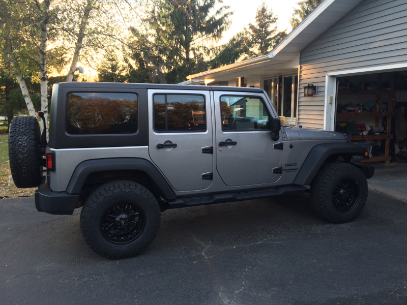

275/7/18 no lift. They rub a bit but not bad. I would consider a lift or at least a 2.5in spacer
