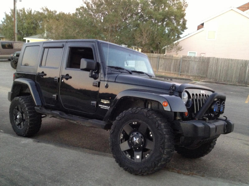

Here's my 07

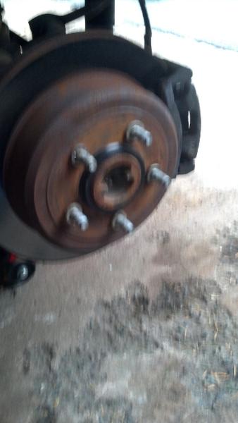

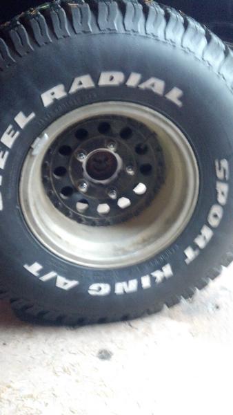

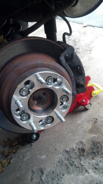

Well finally after battling with these new used 33 inch tires i got them to fit.
I had to first buy 5-5.500 wheel adapters to fit the wheels. Stock jk wheels are 5-5.00 inches. The adapters are 1.250 wide. Then i had to buy hub centric rings to center the adapters. Lets just say with out the rings it felt like riding on square tires.
But hey for 240 bucks i cant complain about these tires they still have alot of life in them. Now i just need some center caps.

you said your wheel spacers were shifting w/o the rings? were you using tapered or flat lugnuts?

All tapered nuts. But the adapters were lug centric not hub centric. So with the adapters on with out the rings the wheels weren't centered properly.

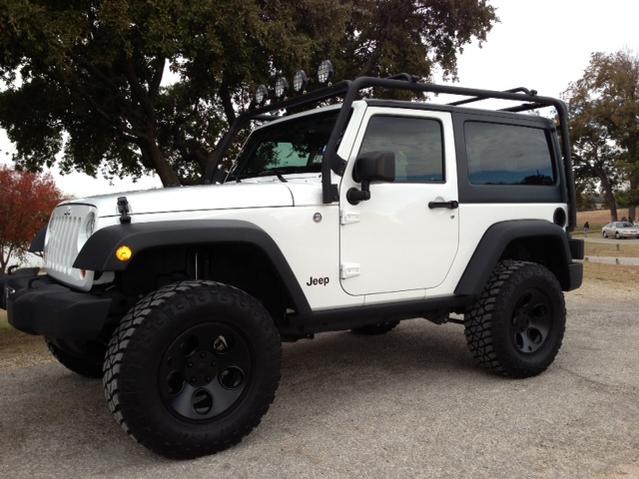

Here is mine...finally finished with mods...."for now!"
2012 JK Sport, Aev Savegre Wheels, Kelly Safari TSR 285-70-17, AEV 2.5 Dualsport Lift, Rubicon Rock Rails, Body Armor (JC Whitney) Rack
