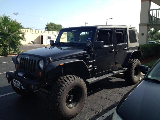

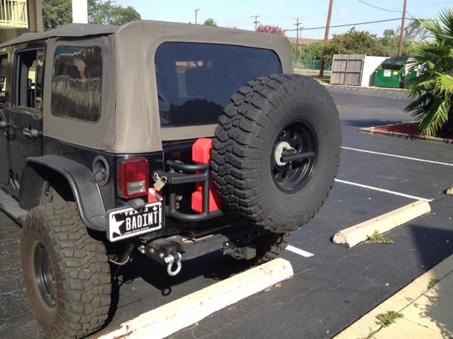

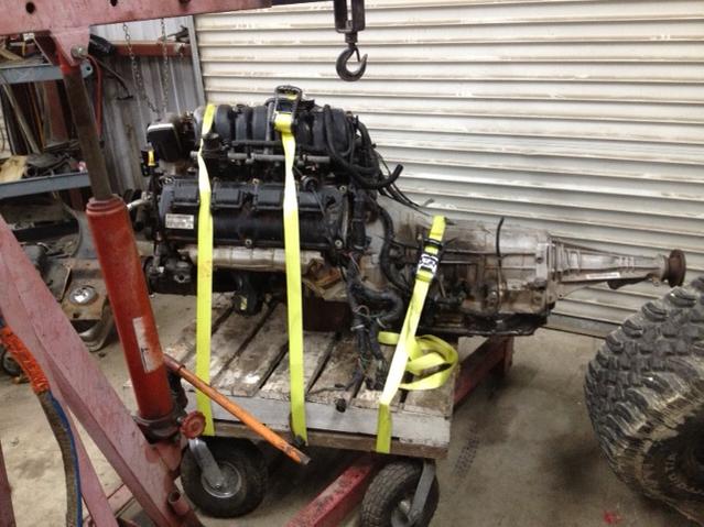

Default Here you GO!
Here's my setup. Then again, damn 35s!! Wait until I put this baby under the hood....hehe

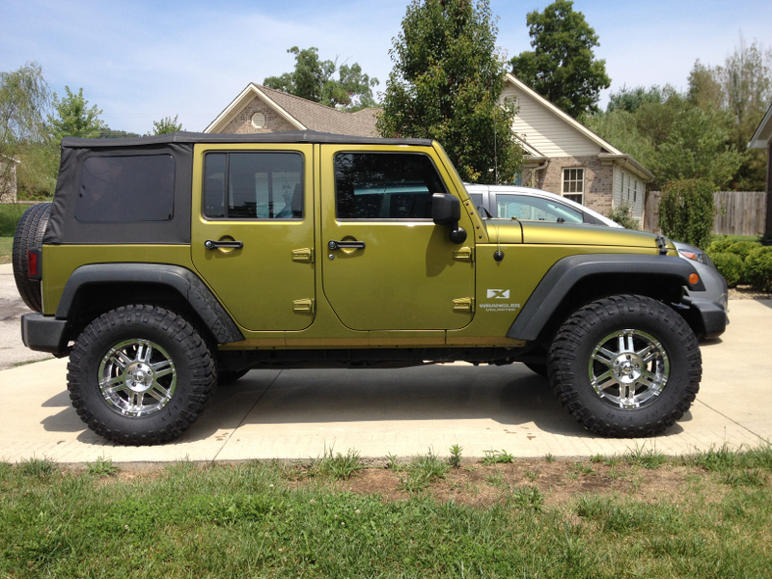

08 rescue green
