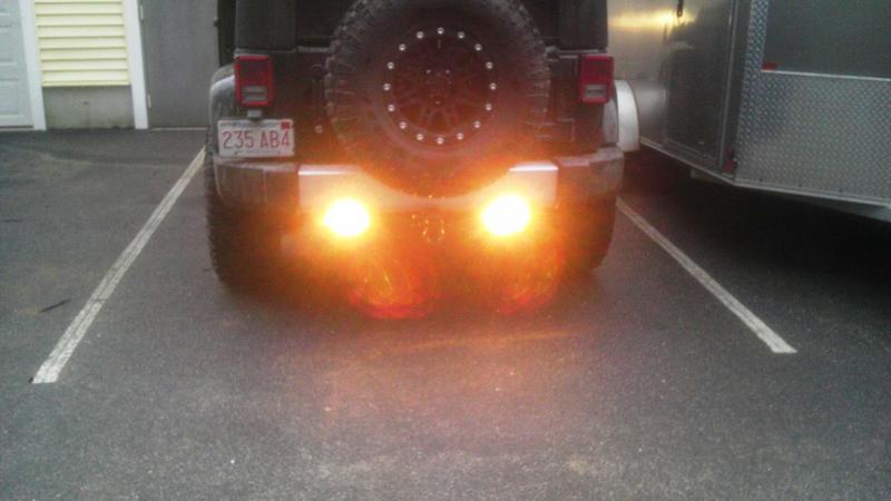

emiles1987 Feb 13, 2012 04:48 AM
3 Attachment(s)
Finally got around to wiring up my lights this weekend. They work great at night, wayyy brighter than I expected. These can also be flipped around facing forward for a 'rock light' effect.
In all spent $19 + $8 for a new switch. Installing lights and running wires took a total of 1 hour 15 minutes, taking my time.
Attachment 277640
Attachment 277641
Attachment 277642

emiles1987 Feb 13, 2012 07:06 AM
Originally Posted by jugast (Post 2846780)
Can you do a write up maybe of how you installed this...what you tapped into and such..
I basicly wiped down the underside of the frame where I was planning on mounting, then applied the light bracket (sticky pad included with kit). Then, drilled 1/8" pilot holes then screwed into place. Grounded to bracket to rear bumper. Wires were fed up through the compartement where the stock jack is kept. There is a small plug, I noched it with utility knife, replaced it and sealed with silicone. All the wires from there, were easily run under the carpet on the drivers side of the Jeep. Power was directly connected to battery with fuse supplied. Connect to switch, and thats about it. These came with great directions with diagrams to follow as a guide.
Real easy to do, great weekend project.
