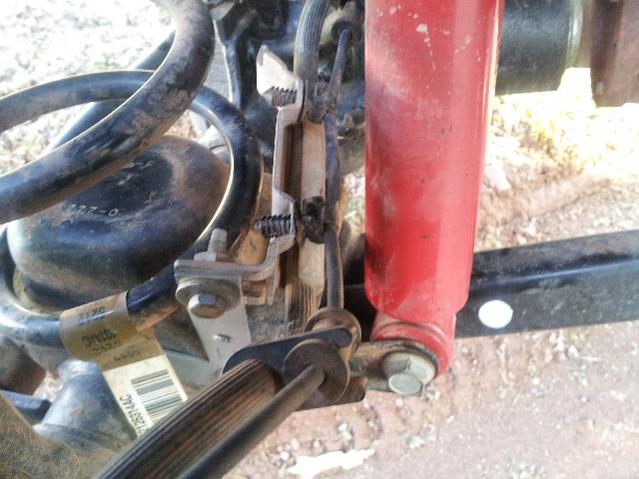

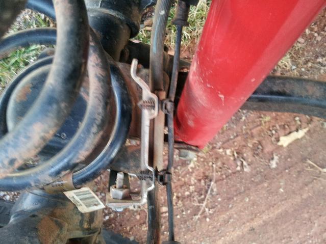

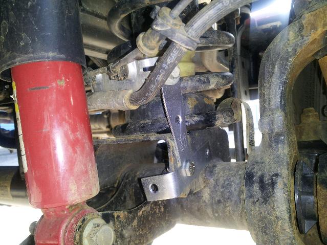

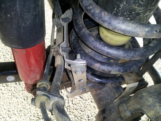

Old Feb 15, 2012 | 12:58 PM
ezav8tr's Avatar
Vet Army
Joined: Jun 2010
Posts: 436
From: USA
I just finished mine and am happy with it. I have a 2dr Rubi with the TF 2.5 BB with shock extensions. The photos were taken at full flex with the swaybar disconnected. I checked both wheels at full flex up and down. No issues that I see.
Hope this helps.
