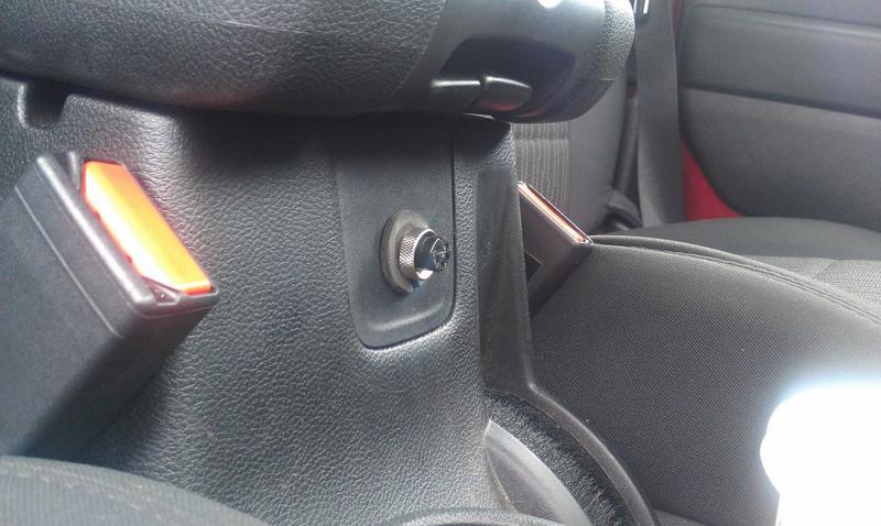

Hi all, Hope this is correct place for this question. I am installing a Cobra 75 WX and plan to place the connector box inside my console. I searched console removal but cannot find how to remove just the inside box and not the whole console. Parts diagrams LOOK like the box can come out with maybe the rear plate. Anyone do this? Wouls really appreciate the help. I can use the 12VDC outlet insiode the box to feed the CB and already have the antenna to the side of the console. Now if I can just remove the interior box...........
Kinda like this.

Kinda like this.
Attachment 327295
Attachment 327296
